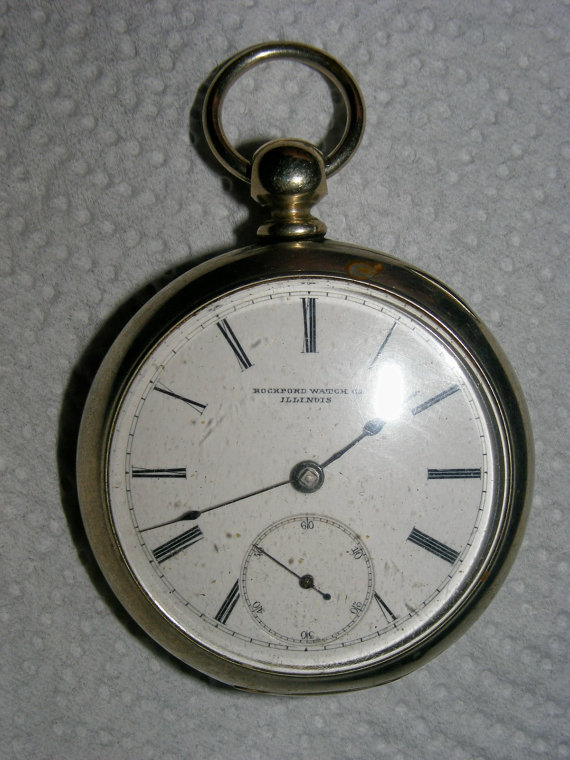

I need some help on this one, looks like 7 jewel
low S/N is it desirable watch ? to have?
is it all correct dial hands?
May 25, 2012, 21:23
Peter Kaszubski
dial side

This Rockford is very much worth restoring for collection because it is;
*Serial Number 26047. Very Low
**7 Jewel Movement, Not common (surviving examples)
***Restorable
****Good dial
*****Mixed hands, one straight, one Breguet style. As the straight staff Fine spade is the Minute Hand (with fitted square center hole), I would change the Hour hand to match that.
