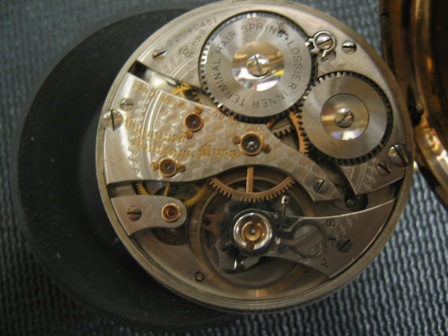

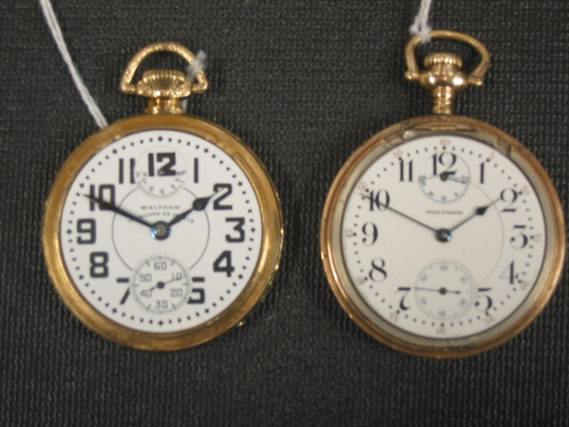

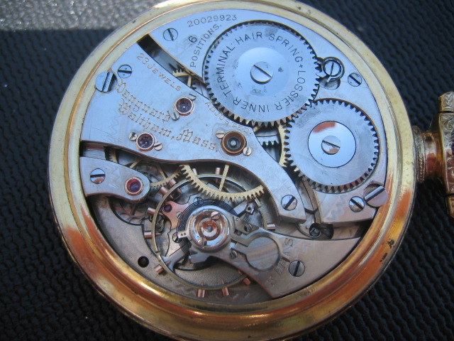

July 28, 2007, 17:10
I totally agree witgh Ed that you leave this watch alone. The WWWCo. diddled with these all along the way and each run is it's own "breed of cat". Note the 2 Pictured. The "more used" s/n 22m (c.a.1918), certifiably did heavier service (right hand watch in the dial foto) than the older, but "better looking (c.a. 1915). Both have Diamond endstone and Lossier Hairspring but they are hardly the same watches!

July 28, 2007, 17:22
Sorry about the fuzzies, the camera is an old one my wife dropped in a pitcher of beer which since dried out and lays around my computer waiting for me to see if Canon can fix it. dca
