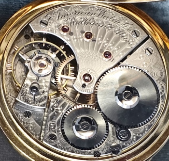

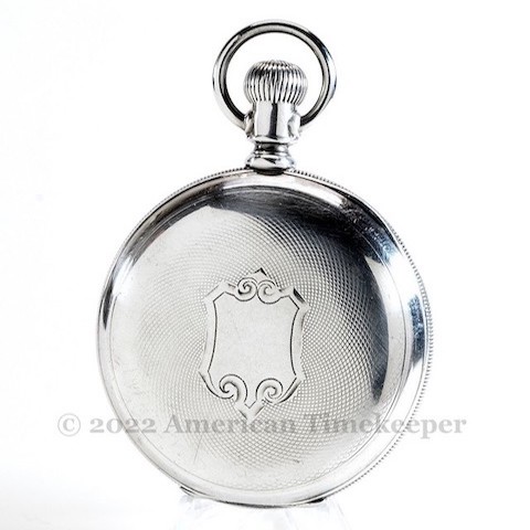

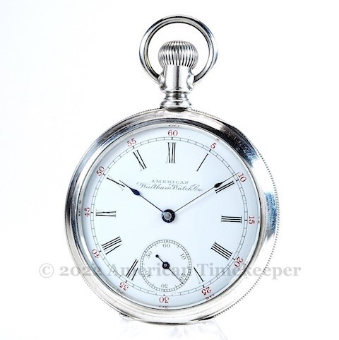

Here is a Waltham Watch Co. Model 1888 19 jewel watch I had restored and got back a couple weeks ago...

AWCO Grade Model 1888s are lovely and relatively scarce watches. Gary, your example is very handsome. Eric ****** does fine watch restoration work. I assume you both are aware that your watch does not have the usually "correct" dial or winding wheels. The dial on these watches normally says "A.W.W.Co." in Gothic letters, under which "WALTHAM, MASS." appears in smaller non-Gothic font. The winding wheels on the 19j AWCO Grade Model 1888s are revered for their finish of tiny straight lines radiating from the hub. I can post photos of examples if you would like to see them.

Here's the movement of my 19j OF AWCO Model 1888. Notice the radial line finish of the winding wheels.

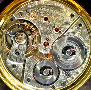

Here is the movement of my 19j AWCO Model 1888 hunter. Note the radial line finish of the winding wheels.

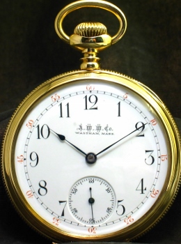

Here is the dial on my 21j AWCO Model 1888 OF. Note that it is the same as the dial on my other two AWCO Model 1888s except that it has Arabic numerals and a red minute track. The hands on all three watches are substantially identical. The hands on Gary's Model 1888 are different, but nice looking.

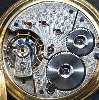

Here is the movement of my 21j AWCO Model 1888, which is in an 18k K&B case. Note that the winding wheels are different; they do not have the radial line finish of the 19js. While this might make those winding wheels seem incorrect, they almost certainly are correct. This 21j was made just after a a run of Riverside Maximus Model 1888s that had similar fancy winding wheels. Wheels like that were used on the subsequent run of 21j AWCOs, all known example of which I have been told have winding wheels like the ones on my watch.

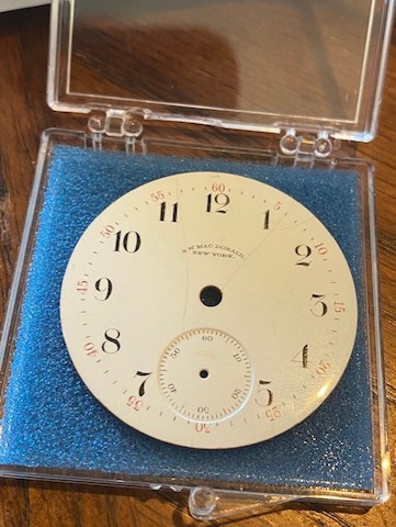

Ethan thanks for the info....I will try to find the correct dial for the watch...Might not be easy but I will start looking...I just found a dial for a Canadian Imperial watch I have and it only took about 10 years...LOL...This is the dial that was on the watch when I got it (not sure if it was original either)...We thought it would look a little better with the dial that is on it now...One thing I found interesting about this watch was the roller table, safety roller and pallet were all gilt colored...

These dial hunts can take time, but persevere. My AWCO Model 1888 19j hunter came with a Bailey, Banks & Biddle dial that not only was unoriginal, but also wasn't the right size. I bought an AWCO Model 1888 parts movement that had the correct dial and winding wheels for $431.68 in 2019. The parts movement dial is now on my hunter. The parts movement winding wheels replaced the incorrect ones on my OF AWCO Model 1888 19j. So you see I know first hand the issues one faces in trying to restore AWCO Model 1888s to correctness.

Ethan, I THINK my 1888 Maximus has similiar winding wheels to your 21J 1888 as you said.
