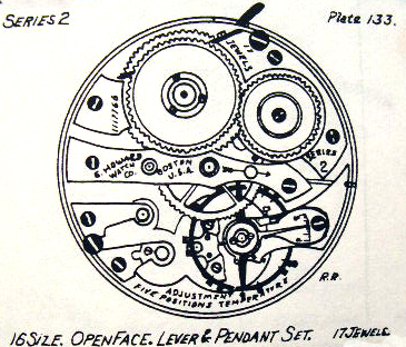

I'm going to suggest that all 16s watch grades made by the E. Howard Watch Co., Boston, USA were designed to be RR grade except for possibly the models made for the gentry who might have preferred a fine, prestigious, pendant-set, Howard movement.
Below are movement diagrams for Series 2 and Series 9 watches.It would seem that there WERE some Series 9 watches that were lever set.

In the 3/4 plate checkerboard Series 9 watch of 17 jewels, they made two versions, an adjusted 3 positions and an adjusted 5 position watch. The 5 position watch would have made the RR requirements and would need to be marked 5 positions in order to do so. I have not personally seen a Series 9 with the checkerboard damaskeening marked other than "adjusted" which meant 3 positions from the time frame the watch would have been made and used. I feel they may be out there so perhaps a member would share a 5 position Series 9 with the checkerboard damaskeened pattern with us if they might in fact have one Confused
You tell us of a 3/4 plate lever set watch with a checkerboard damaskeened pattern in 17 jewels that you have with serial # 983636. To me there is no doubt that it is a Series 9 mvmt. Is it marked "adjusted" or "adjusted 5 positions" Confused That would tell the tale as to whether its a RR watch or a "gents" watch. Better yet, howz about a picture which would speak a thousand words Confused
