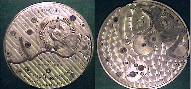

David AbbeIn May, Sheila sent me this watch for review, and I posted the following letter about what I found with a list of parts needed . . .
Sheila’s Seth Thomas Project
Arrived May 27, 2008
Sheila Gilbert's Seth Thomas has arrived for restoration! For all concerned, Sheila has agreed to let us try to bring this 21 Jewel model 260 beauty back to life! It arrived today from Sheila as pictured below, and Brian C. and I have agreed to make this a "project" for Sheila. I will start a new thread as we progress to bring all of you up to date on this very fun and important restoration of a fine Timepiece. Hmm, on first look, it needs a Balance staff, Main Wheel, Cannon Pinion and Hour Wheel, some screws, a Dial, Hands, a Case (Sheila how about that 18s Silveroid you posted recently?).

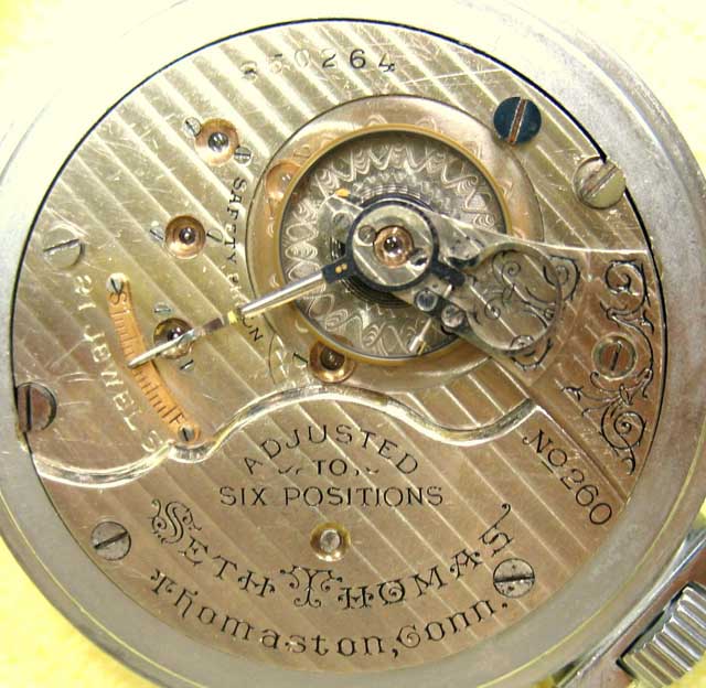

May 28, Watch Disassembled and inspected.
Some other details,
General condition;
Main Spring barrel and arbor; all very good, it appears to be reworked barrel and spring with torque pin soldered in barrel, and spring made with a folded-back style clip.
Jewels; look OK
Balance Wheel; Double Roller, Jewel Pin and Balance spring OK, top pivot of Balance staff is broken.
Train;
The Main Wheel Cannon Pinion Shaft is broken off. New wheel or wheel staff needed.
2nd wheel , seconds wheel, Escape wheel, and Pallet fork assembly are all OK.
Wind and set parts; All appear to be there except cannon pinion and Hour Wheel.
Parts needed,
Regulator for this model Whip style
Balance Staff
Main Wheel or staff
Cannon Pinion & Hour Wheel
2 more matching Movement Screws
Good Dial and Hand Set
Decent Lever-set Case.

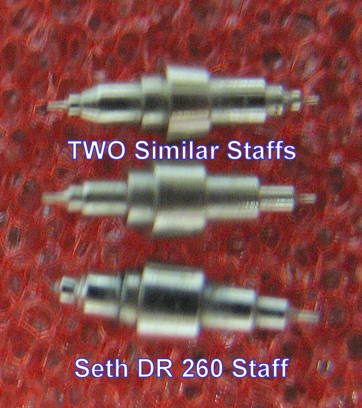

David AbbeThrough the following few months most of the parts were rounded up, many thanks to Bryan Cavenaugh who with his generous research, recovery, and most reasonable sale from his large supply of spare parts has been instrumental in the recovery of many many Pocket Watches.
After an interruption due to a business matter, I was able to attend to this project again late this spring. The biggest challenge was finding a replacement balance staff for the very rare double roller movement!. Close inspection showed that some staffs were very close . . . So I took it to Vladimir to consider the possibility of making one of my "close looking" ones work. Vladimir soon discovered an Illinois Staff that fitted "just like new"! (He also observed this is an Illinois wheel train.

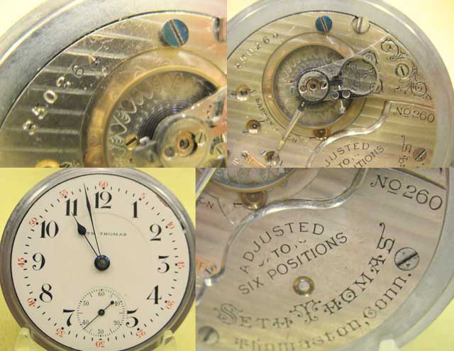

Eric UnseltPretty movement - especially under the balance wheel, great dial, and excellent hands. Nice!
Is that plate screw blue for a reason?
June 05, 2009, 13:28
David AbbeThanks for the comments, more to come about the watch, after 24 hours it "lost" 10 seconmds.
As for the condiiton of the plates, I speculate that it knocked around in a Jewelry box since the 1930's (after the case was sold for Gold scrap). As the Jewelery box was full of hatpins, stickpins and other sharp edges and points, it is amazing that it survived as well as it did.
The "blued" plate screw" came with it and will either be replaced or polished while the "finishing details are done early next week.

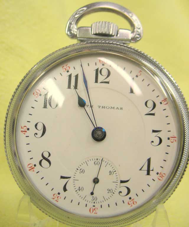

David AbbeThe "Wrap" on Sheila's rescued Orphan Seth Thomas watch to restore it to where it is now took the following help;
Brian Cavenaugh;
Regulator Whip
Main Wheel with staff (Complete)
Cannon Pinion
2 Pillar Screws
Hour and Minute Hands
Hour Wheel to fit Cannon Pinion
Dave A.
Cleaning and restoration work
Base Metal Case
Regulator Adjustment Screw
Dial
Second Hand
1 Pillar Screw
Valdimir Gelfer
re-staff and Poise Balance Wheel
Thank You everybody!
Now all that is Left is to hear from Sheila!
Sheila, please respond to this Post or the e-mails I have sent you. I pray that you are OK!
