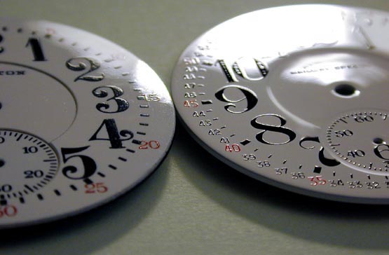

Below, nice 16-size replacement dial currently offered by S. LaRose...July 21, 2004, 02:56

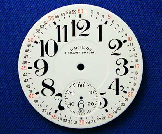

Now, scroll back and forth between the LaRose Replacement and the real thing. Notice the sharp distinction on the three different levels of a genuine double-sunk dial. As Jim Haney correctly pointed out, there is also a huge difference between the "dead" look of a painted dial as you see above and the vibrant beauty of an original porcelain dial such as you see in the image below.
Below, here's a genuine Hamilton three-piece porcelain-enamel dial...July 21, 2004, 09:14
The closer you look at the ORIGINAL PORCELAIN DIAL on the left and the REPRODUCTION PAINTED DIAL on the right the more apparent the differences will be. The dials like you see on the right are offered by S. LaRose Inc. http://www.slarose.com/ or 1-888-537-4513 at very reasonable prices. They are a fine value and great for a "daily carry" watch in order to avoid damage to an original dial.

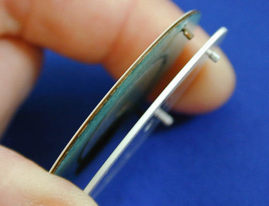

Now we are looking at the edge of both dials. The method of construction is readily apparent. You can see on the left, porcelain is fired onto both sides of a copper core. On the right, a metal disc with heavily painted surface. On Lever-Set watches, look in at the lever slot and you'll pick out these same details.
Check the edge of both carefully, they are obviously very different...July 21, 2004, 09:39

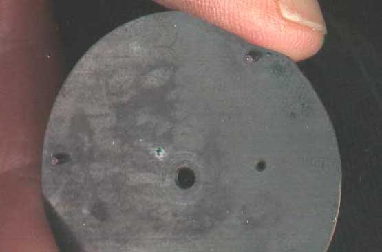

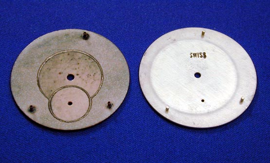

Finally, we turn the dials over and see more differences. The genuine Double-Sunk Porcelain Dial is soldered together from three individually crafted pieces. The reproduction dial on the right is clearly made in one piece using far simpler methods.
From the back all doubt is dispelled about which is the real deal dial...July 21, 2004, 18:33

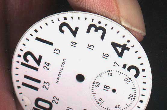

Charles CardJust to add my two cents worth, here is a melamine Canadian dial that a friend insisted on putting on his 4992B. Probably not appropriate, but note how similar this is to a replacement dial.
July 22, 2004, 11:06
Charles CardMelamine dial front
July 22, 2004, 23:55
