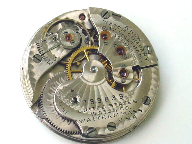

Samie L. Smith
here is the 0 size from the same co..

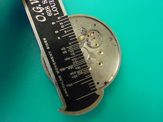

Samie L. Smith
I have Mark,s watch spread out on my bench this morning..
It is a 18 size 3/4 plate movement

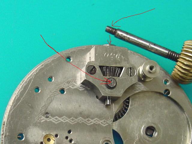

Samie L. Smith
These have a unusally system on the winding stem there is a screw which you tighten in order to unscrew the winding stem..as you can see in the picture both ends of the winding stem are threaded..the screw is accessed from the train bridge side of the movement
Took me a few minutes to figure how to remove the stem

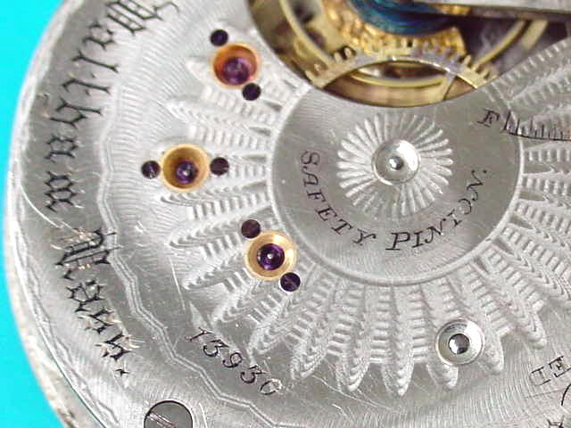

July 22, 2006, 10:29
Samie L. Smith
It is a 15 jewel movement

Tom McIntyre
The somewhat earlier dome model had the same stem mechanism. If you have the watch in a case, getting it out can be a real mystery. Eek

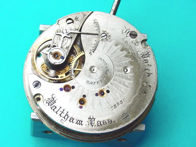

Samie L. Smith
Mark
Here is another picture of your movement 18 size 15 jewel 3/4 plate.Overlook my pictures they don,t do justice to the watch..
It is running okay in all postions except dial up still have to figure out what,s wrong ,but for the most part completed..I will post another picture of the watch when i get in back in the case..

Thank you very much, Samie!
Well folks, there she is....an 18s 3/4 plate U. S. Waltham of Waltham, Mass, and not listed anywhere that I've found to date.

Hello Mark and Samie,
A nice find - it is an early watch ca middle of 1888!
Samie - nice photographs.
