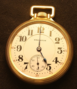

Hi everybody! Thought I'd post some pics of my favorite baby, my 992. I bought this last year for around $200.00. The serial # is 2486027, which puts it at 1927-28. It's in a Star case, which I know is not original. However, I just purchased a Hamilton/Keystone Rail Road Model 5, white gold filled, on ebay that I believe to be period correct. The dial is a single sunk HG. Is this dial correct? Or does it need a DS dial? I've read here in the forums that mine is an "emergency" dial. What do you think? Brad

Edward L. Parsons, Jr.Brad,
Your watch is fronting a SS Heavy Gothic dial Dial 080 from the 1940's. You need an earlier DS dial, something like a HA Dial 576 or 522, or possibly a CPR Dial 577 (see picture).

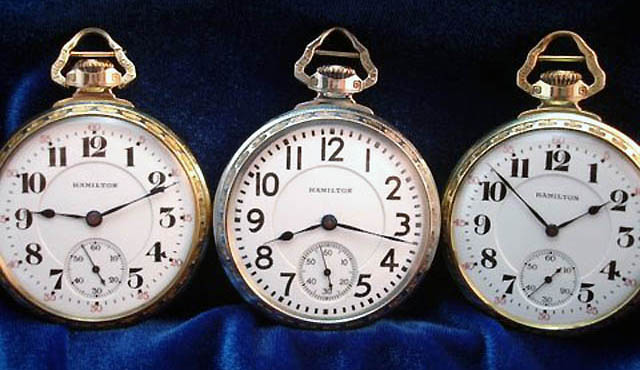

Jerry KingBrad, this is what your watch will look similar to once it is in the Mdl. 5 case....esp. the one in the center....

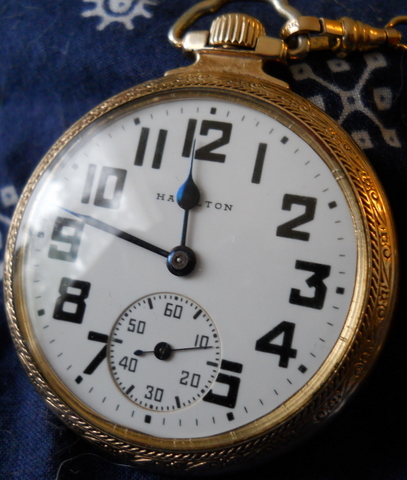

Richard RomeroBrad,
Another option is the Heavy Arabic 436 dial.
RR
Serial number 2473499

Richard RomeroHere's some more pictures of the "older style" hands on 992 factory RR cases. Is the CPR correct with these hands? I don't know.
Here's a link that may clear up the "older style" hands on a 436 HA dial.
992 Railroad Watch - Is this an original set?RR

For the Montgomery(Numerical) dials, in a model no. 5 case, whether a BMN 522 or a HA N 581 the correct hands are shown above in Jerry's post on December 22, 2010 19:04.

Often said it's always best to collect non-argumentative examples and the above Model No. 5 with the HA 436 dial and "early type" hands clearly shows why. As far as I know there's no documentation to prove the hands are correct. It seems the way it's been determined the hands are correct is by enough examples being reported for it to be more than coincidence. When your watch is complete it will be non-argumentative.
By the way that is my watch posted above and I've decided to leave it that way because that's how I found it except for the hands which were the same style but cut very short.
