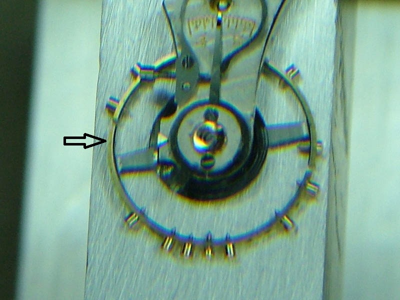

I am trying to replace a missing balance screw on this 914. The pair or screws i am attempting to use are off the balance of a 910. The problem is they are a different size or thread. I believe these are referred to as mean screws. Should these be the interchangeable 910 to 914? If not where can i get a pair that will fit?Any help would be appreciated. Sorry the picture is a bit out of focus. Paul

Paul, that is one of the mean time screws. I suggest that you check with our IHC185 member Brian at;
pwpartsetc@pwatch.com
I would bet 1 90% probability he can help you with a pair of those.
REMEMBER MEAN TIME SCREWS ARE NEVER SUPPOSED TO BE "BOTTOMED OUT".

Dave: Thanks. He is the one I bought the holders from. Paul
July 29, 2011, 09:41
Paul Arsenault
Dave: My mistake, Dave Coatsworth is the one i got the holders from. I sent Brian an email. Hope he has a pair. Paul
