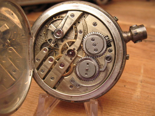

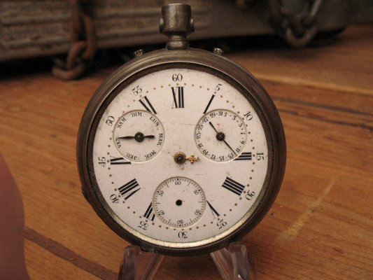

I picked this watch up today. It is Swiss, Siver case, and not running. Does anyone know what it is and is it worth restoring?
This was posted on "Pocketwatch Discussions", but since it is Swiss I thought I'd ask that it be in "European Pocket Watches" as well. See the photos below. Any help would be appreciated.

It has some dirt and fuzz in it.

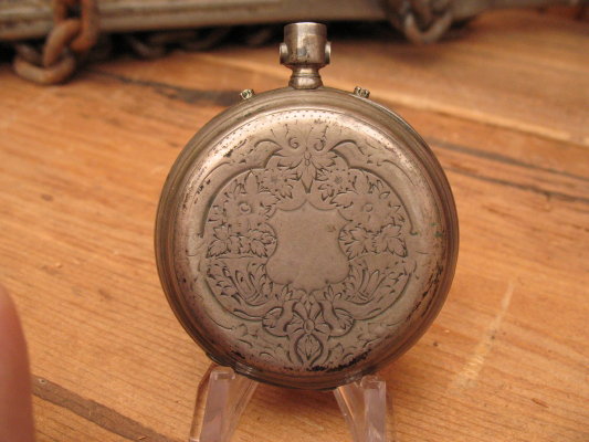

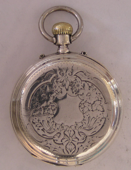

The case is neatly engraved, hallmarked siver,(Shiled with chevrons, Argent, would be .800 silver content) and in good shape with bow and stem/crown missing

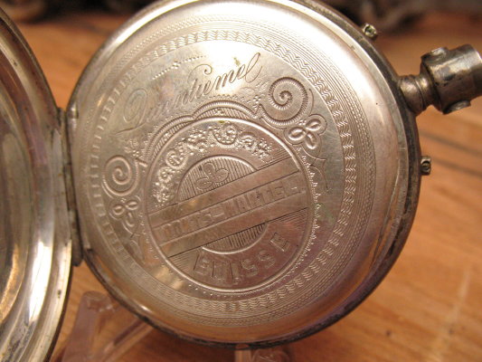

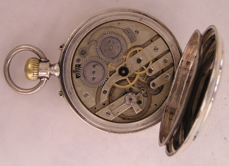

Someone etched out the name on the inside. I don't know how well this will show.

A nice watch and not so often found.
It is a PW with calendar function. The sub dials show the days of the week (mon. - sun.) writen in french on the left side and the date (1 - 31) on the right side. On the inner dustcover it reads `quantième' - day of the month.
The manufacturer is anonymous,only a faint hint: the 'ponts martel' is the swiss 'Les Ponts de Martel' in the swiss watchmaking area. The watch dates to 1890 - 1900. The movement is a mid-range quality swiss-lever movement stem-wound, pin-set.
One of the small pins is for setting time the other for setting date. The dial looks dirty but ok. I would give a try to restoring.

I had a few of these over the years, they are what I personally classify as Swiss novelty watches, you may have seen them with 4 dial calendars, cheap chronographs double sided with date on rear and many other variations, if it running and the function are working both manually and automatically maybe just worth putting some work into, if any of the calendar parts are broken which you often find due to mishandling and meddling, parts are not easy to find event the stem you may have trouble finding if you don’t get lucky with a match on other similar Swiss range watches. It could get expensive fast to fix , if it is was mine I would remove the dial and see how complete from there would be a “fixer upper” once I found another donor to make one good one, or should it have problems store for a parts watch. Can you see the shaft for the second hand?

Thanks Gerald and Chris, Yes Chris. It appears the shaft is there for the second hand, but I cannot tell if it is functional. I can rock the watch and the movement appears to function fine. I can see that at least one, and probably two jewels are broken and need replacing. I'm not able to see how this dial is removed, or how the movement is removed for that matter, but other than dirt, the dial is fine.
I guess I'd like to know an approximate $$ figure if the watch was in good running order, and about what it would cost to repair it. I know the latter is difficult to determine without holding the watch and looking at the damage and availability of parts.
If I don't choose to pursue repairs, then I may offer it for sale as a parts watch, or to someone with actual talent and knowledge to work on.

I partially disassembled this watch and did some cleaning. The movement was really dirty and gummy. I cleaned the dial, and it came out really well. Didn't actually soak it, but rather sprayed it with cleaner and rinsed it off. The dial is not perfect, but is in very good condition.
I also took the balance out and cleaned and oiled it, as well as the pallet fork. I really didn't think it would help, but when I reassembled them, it RAN. Now, since it is (as they say on ebay) a strong runner, I need a bow, stem, and hands.

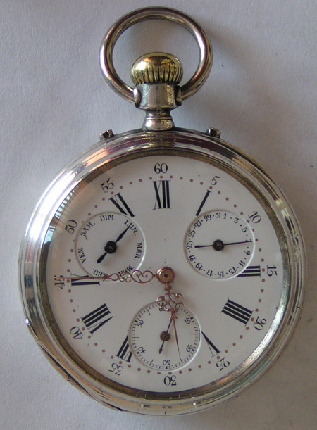

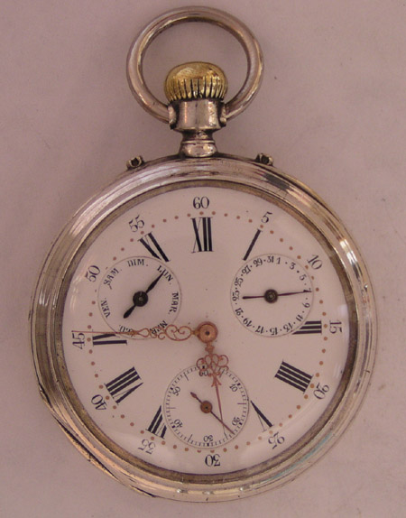

I'll try and post photos of the repaired watch. I don't actually have it, but should get it back within the next two weeks. It is supposed to be repaired and keeping time, after a clean and service.
July 08, 2009, 20:49
Mike Hodge
another
July 08, 2009, 20:50
Mike Hodge
The case
July 08, 2009, 20:51
Mike Hodge
And final photo

That is awesome.....I think it is a pretty cool looking watch and you did a good job on it.

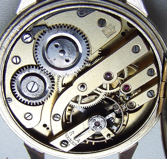

I have a watch with a movement very similar to yours, that has a movement that is completely unmarked. I did some research and it turned out to be a Moser. The only way I have identified mine as a Moser so far is comparison to a Moser watch with the Moser Stamp. This picture is the Moser with the stamp.
Moser watch
July 11, 2009, 22:05
Mike Hodge
Thanks Wayne. I agree it is very similar to the photo you posted. I'm not sure how to research this, but it will eventually show its origins.

The watchmaker who did the work did not have a specific brand for me, but described it as a high quality movement with 16 jewels, produced around 1900. I am anxiously waiting for its return. Should be within the next two weeks.
