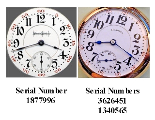

Ok from what I think I am understanding it looks like maybe two of the watches I have have the correct dials.
I was mistaken only two of the three are under 3,000,000.
Please take a look at the picture. I have two dials and the serial numbers are under the dials I have. I think the watch with serial number 1,340,565 has the wrong dial. I believe it is too modern. I also believe the other two are correct. If I am correct which dial should the 1,340,565 watch have?
Thanks again for your help.

Richard Romero
The dial on the left.
RR

Harry J. Hyaduck Sr.
Thank you Richard. I was afraid that was the dial. I was hoping it could have used either dial. Oh well at least I know now and I can keep an eye out for a good dial at hopefully a good price.
