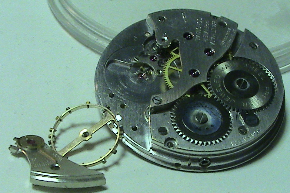

As openers, I must repeat that along with the seller of the remaining LaRose stocks, IHC185 has the cooperation of another of the nicest and most agreeable "original" maker parts sources available today; Brian C. at;
pwpartsetc@pwatch.com
This time, when I received a 12s Waltham and was "astonished" Eekto find an "empty nest" with only a very used staffless Balance wheel. In a parts tin marked "12s Colonial", Brian C. found the exact parts I needed . . .
August 31, 2008, 11:38

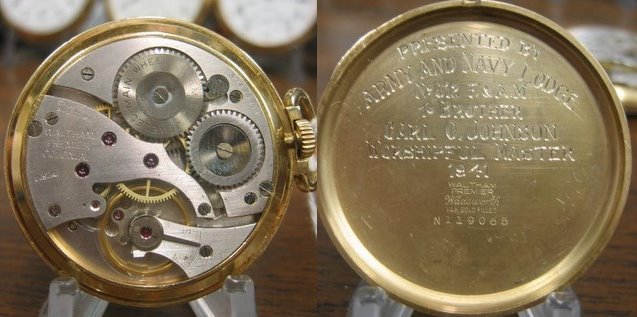

Which allowed me to quickly and efficiently rescue this 21 Jewel Waltham-Cased 12s Colonial . . .
August 31, 2008, 11:39
Which fully deserves it's restoration to honor what must be quite a piece of History! Cool This restoration raises to almost 30, the "count" of successful restorations due to the "Two Br(y)ians". THANK YOU AGAIN!
