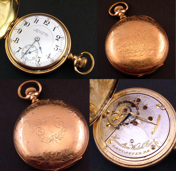

I have recived information that the Hamilton 927 should be quite rare. How many of these were ever made. What other information can I get about this item.
Bernhard "the swede"
February 16, 2004, 07:30
Terry HillSorry, not "low" production...... 45,781 by my reference......
February 16, 2004, 07:34
Bernhard Schmidtmy knowledge is very low but isn´t 45 000 items quite low compared to other similar grades or is it a normal production?

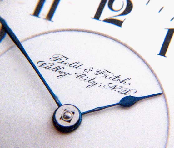

Still a BEAUTIFUL WATCH you have Bernhard. The rarest thing about it may be the dial, what does it say on it?
February 17, 2004, 03:16
Bernhard SchmidtTha dial says:
Field & Fritch
Valley City, N.D.
....se picture
Is that a jewelers, manufacturars name or what? Where is that lacated?
February 17, 2004, 19:25
Lindell V. Riddle Field & Fritch in Valley City, North DakotaThat's in one of the Northern-Most areas of the US about half way across the country. Take a look at this link...
http://www.google.com/search?q=Valley+City,+North+Dakota&ie=UTF-8&oe=UTF-8Looks like a small town and it's apparently a Ski Resort Area. From the link above you might eventually find the way to information about the retail jeweler who originally sold your watch. That could prove very interesting!
Let us know what you find.
One other thing, looks to me like the minute hand with the square center may have been intended for a key-wind key-set movement. Interesting.

What are the markings on the case for your 927? I just bought a Hampden Special Railway in a VERY similar case. It is almost indentical. It is a "Crescent" watch case marked "warranted 25 years" which would make me think it is gold filled but it has a look to it very similar to polished brass. It also has a hallmark of a flag with a star in the middle. Anyone know the composition???

Bernhard Schmidt...the case says exactly like this:
Dueber Special case, Gold or not?...the topic from mr Chris Abell, but mine has the sn 4666313

Bernhard SchmidtLindell,
What is the difference between differnt type of movements hands. How can I separate them from each other?
Swede, is that a vegetable....aswell?
February 18, 2004, 07:51
Terry HillDavid,
The 946 production info is correct as per my reference.....
case.... Image of marking? Possible wear and polished?
Hands......
If you look at the where the center post extends into the minute hand, note the "square" shape of the opening........
this is what indicates the hand would be for a keywind....as the post on the keywind/keyset movement is 'square' to allow the watch to be set....
it just so happens on this example the size of inscribed circle of the square fits the round arbor of the watch........
It works this way sometimes... but You "cannot fit a square peg into a round hole"
