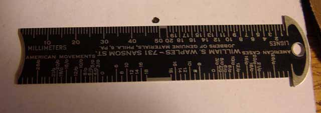

Finally got this watch today! Long trip from Canada!
Watch listed as running and stops, but it was wound tight. Took it apart and found a huge chunk of debris around the escape wheel. I think it will feel a lot better now.
