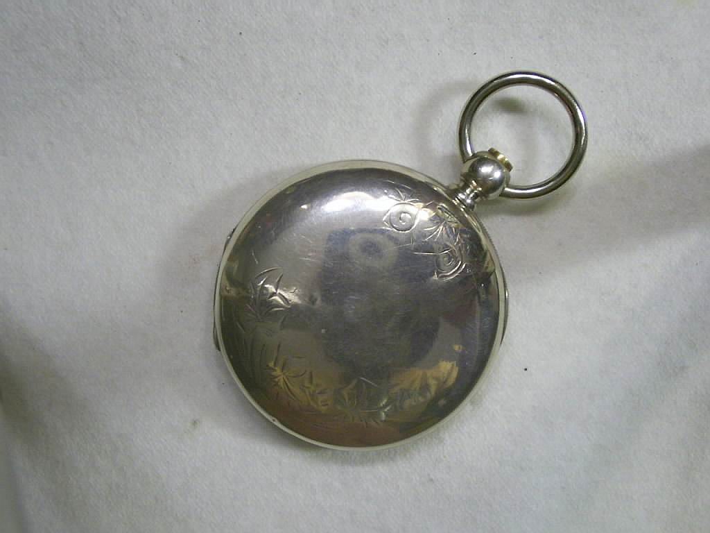

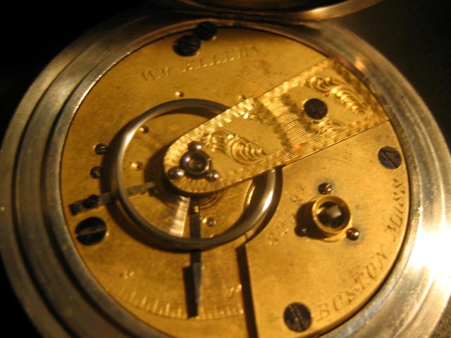

I have been wanting a Civil War pocket watch for a while now,and just haven't been able to score one. I have a watch collecting hobby,and a truck driver's budget. I saw and bought this on Ebay. Talk about your fixer uppers. I have the needed parts,on several model 57 parts watches,and MAYBE I have the ability. My question is I guess,should I even try to revive this,or add it to my parts bin.
Another question,how can a proper keywind case for this era watch be identified? I have a couple of nice keywind cases,but I'm sure they are from later,maybe the 1870s or 1880s.

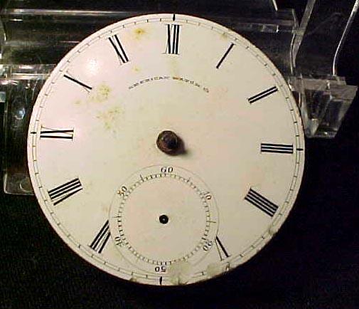

Another shot.

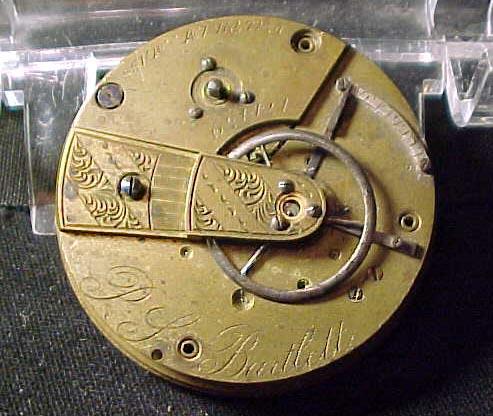

Last one. The serial number dates this to 1864.

Cecil you pose a difficult question to answer correctly without knowing more about your'e other parts movements. It was produced in 1866 the year after the Civil War ended and deserves care for that fact.
That said, the watch you picture looks pretty well "out of it". The amount of material it would take to restore it would be considerable.
Even though it is a 7 Jewel movement which may be easier to restore than the "porthole jeweled" types, the result may be a disappointment.
The hand-made Pinned Dial looks repairable, the 4th (seconds hand) wheel looks OK, and there are probably more things in there that are also salvageable. If it were me, I would save it for parts and keep hunting.

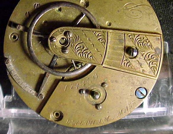

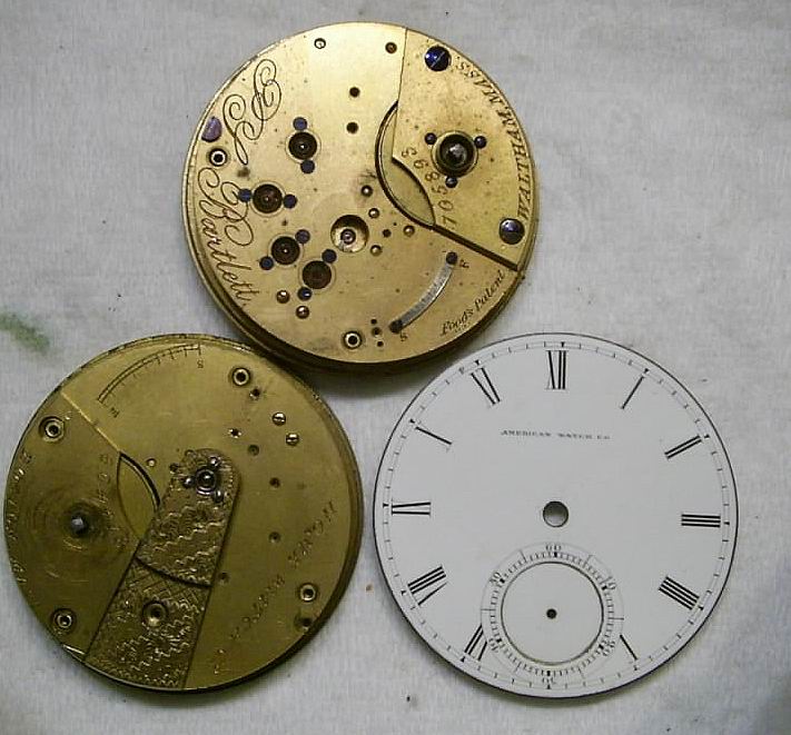

Here are a couple of my model 57 parts movements. I have a couple of others dismantled,and I have a perfect pinned dial. These movements are a little later,but the parts should work. According to the serial number on this movement,171450,and the information I can find this movement was made between 7/1/1865 and 7/31/1865. I know it kinda looks like 174450,but that number comes up to be a model 1859. The main attraction to this movement to me aside from date of manufacture,is that it looks to be complete,and all my others are missing some vital parts.
Sheila,I haven't given up on it yet. Main problem that I can see,is maybe finding a balance staff for it. It is what I call an undersprung movement,meaning the hairspring is under the balance wheel,and I have never done one like this before. But,I am very patient,and kinda stubborn,so maybe it will (live?) again.
February 24, 2009, 10:55
Cecil, I see your point and looking at your parts movements, if the parts are OK, the Home watch movement has top Jewels and Jewel screws, the P.S. Bartlett has a better regulator scale and a Key Winding Guard ring. I would repair the Hand-Drawn dial which is more "original" to the time of manufacture.
You might be able to do some "bartering" for watch hands, etc., with Chris Abell if the "porthole" jewels in the P.S. Bartlett are what He always seems to be looking for.
As the Balance wheel needs a thorough cleaning and re-polishing, I have no idea what else it may need, ceretainly a staff (we are all looking for these), and possibly a Balance spring, a Roller, Roller Jewel, etc.
Quite a project, but "do-able" if you have the fortitude. I have one similar movement just for reference it is pictured below

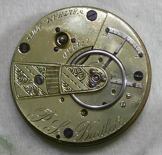

Hey Guys/Ladies, Well, I got it in the mail this morning,and it is now ticking away on my desk. Would you believe,the staff is good. It needed a mainspring,roller jewel,top jewel,escape wheel,and a pallet fork. I got the needed parts from those other movements,put it all together,dabbed a little oil on the needed spots,wound it up and off it went. I will run it for a few hours,until the mainspring runs down,then it will be disassembled and properly cleaned. I can never do that first. I gotta see em run first. I still get a thrill seeing an old movement like this running again,after who knows how many years. After that,I can take my time and do it properly. I'll put up a picture when it is finished.

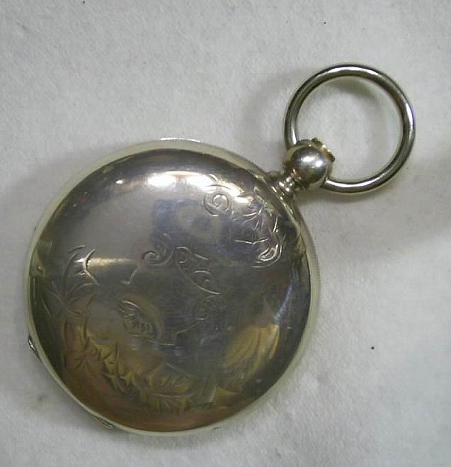

Well,here it is. My version of cleaned up and running strong.
February 28, 2009, 08:50
Cecil McGee
The hairspring is a little out of round,and I can't seem to locate a proper balance bridge screw. I have another good hairspring,but I hate to mess with it,taking a chance of breaking the balance staff pivots,so I'll leave it as is for now,and maybe one of these days when I feel a little more confident with my abilities I'll change the hairspring.

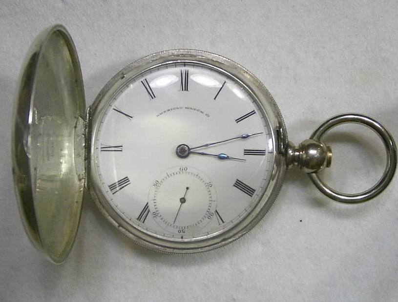

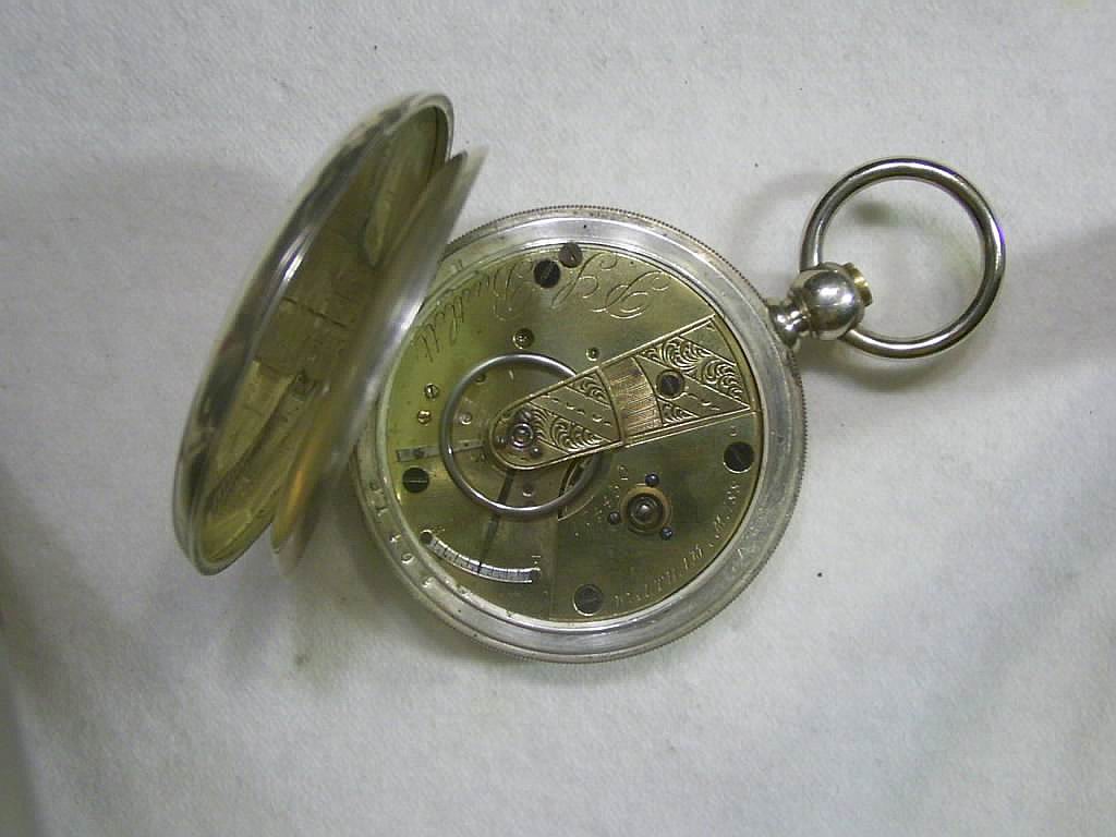

It is finished for now. I still have a couple of small issues with it. David,I took your advice and left the original dial,which I will have to have repaired at a later date,and it still has the minor hairspring issue. I have timed it for 12 hours now and it is still within 1 minute of correct. Not really bad for having no adjustments made to it. I had this Fahy's coin silver hunting case in my case drawer,and it seemed just the perfect one for this watch. I have about 15 hours in this watch,and so I will just be satisfied with what it is for now. I'm pretty satisfied with the end result. Not perfect,but plenty good enough.

Very (x100 very's) Nice. Great luck on the staff being good. I am glad you retained the dial as that is certainly the right one for it, and heck the chips are part of the "provenance"! A minute a day for this is like "free lunch"!
I stand corrected on the dates, this is civil war period! looks like a 700 piece run!
A question, does this look like the jewels were re-bushed or are there still two pairs of press jewels in the movement to make the 11 Jewels specified?

The balance pivots do not look to be worn at all,in fact,it kinda looks like someone put in a new one and never ran the watch after. No evidence that I can see of rebushed jewels. The numbers just don't add up. This is not a model 1859,not 11 jewels,and I have found three different publications,that place the serial number anywhere from late 64 to late 65. Even Shugart's book puts it in 64. I think that model number is just a mistake someone made way back when and it just stuck,or Shugart's book has the wrong picture under the model 1859. It shows the model 1859 as kw ks from the back. I'm so confused. But,at least the watch runs. Also after it was cleaned up the number did turn out to be 174450.
March 01, 2009, 17:20
Cecil, I agree that this has to be a P.S.Bartlett according to the data I showed, there is little doubt of that. The Jeweling reported in the Factory production logs may not be absolutely correct for all movments in that run, but the main top plate is correctly marked for the reported movement and the serial number points to that too. My question about the jeweling was regarding the pivots for the 4th wheel and the escape wheels. The 4th wheel top plate pivot bearing looks in the picture like it could have been re-bushed by a watchmaker repairing it with a brass bushing after the jewel had been damaged. Not important, you have a nice piece, expecially with that case.
