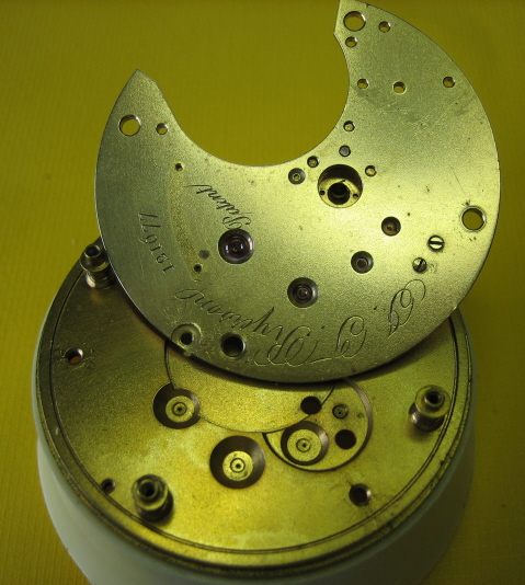

HI Dave, Hope you don't nind if I butt in like this but it just happens I came accross this subject a while ago on an 1870 Elgin J.T. Ryerson. I was quite surprised by the absence of jewels on the dial plate, (where nobody can see them). It is an 11 jewels movement. I even took a picture, and here it is

Yea, this is a good example. That's why I couldn't understand the idea of "pairs".
Up until now, I would have assumed that the jewels in any watch would have an opposing jewel on the other side!

Peter that watch you show, s/n 121077 is recorded by Elgin as Grade 55, 7 Jewel movement, some being the signed Ryerson model. The top plate has evidently been "up-jewelled" to make it 11 Jewels, and it is a good example of a overjewelled "for Show" watch, and also an interesting variant of a 7 Jewel factory movement.

HI David, thank you for the info, yes, I thought this watch to be a bit odd, it is the oldest american pocket watch in my collection. I also find it strange it is listed as hunter, not as open face.
They did not mention the upjeweling on the plate, you would think they would have used it as a selling point, unless it was a special order..God only knows what was the reason, 142 years ago.

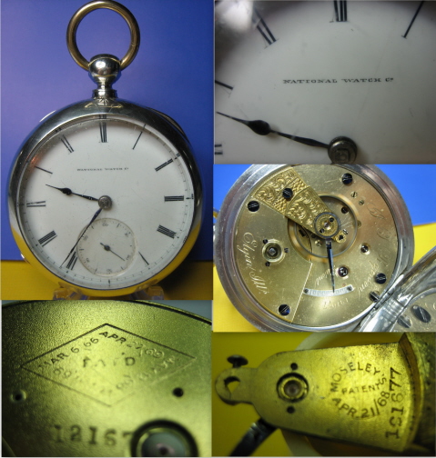

Here are some pictures of the watch,I found some of the patent details interesting, please let me know if you find something else about it.
