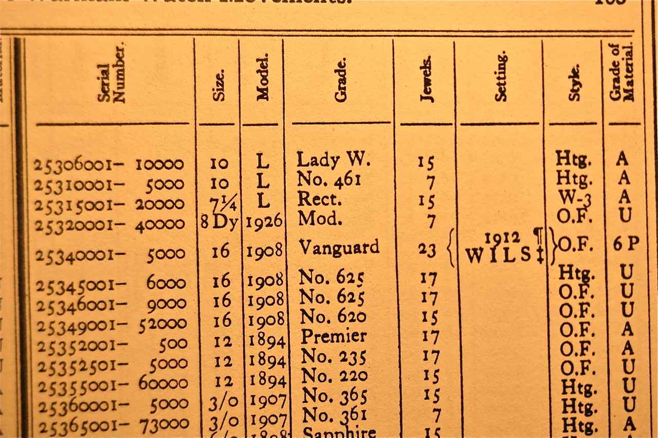

December 01, 2012, 11:31
Gerald Szal
OK Pete: Here are the listings for what should be your watch. Five additional posts should come in with depictions of the parts and part numbers for each. After you determine what the part number is, I suggest you go to the "Wanted To Buy or Trade" section, refer folks to this post, and see if you get an answer. Sorry that I am not familiar with this watch. Good luck. -Gerry

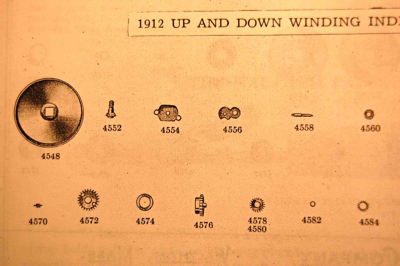

December 01, 2012, 11:32
Gerald Szal
2nd photo of 5

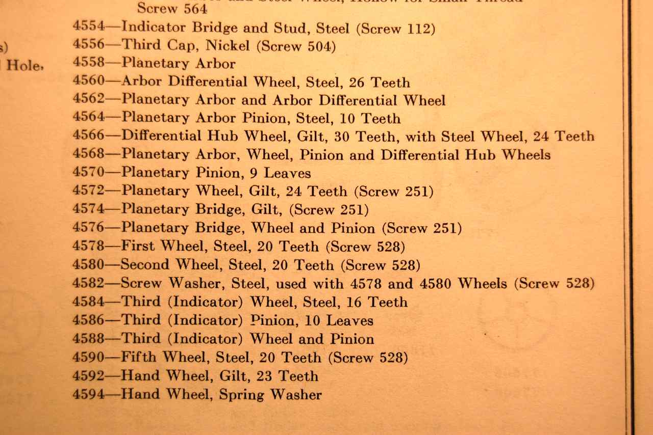

December 01, 2012, 11:33
Gerald Szal
3rd photo of 5

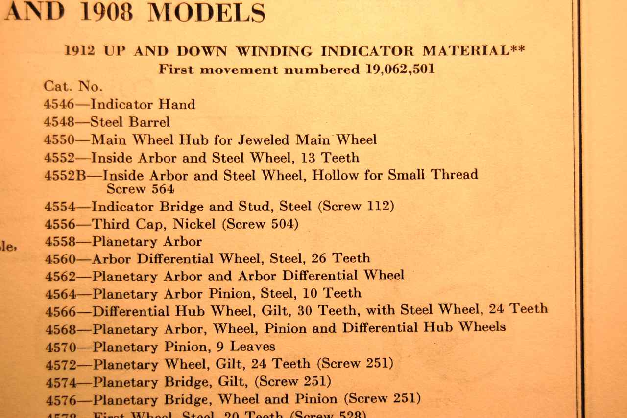

Gerald Szal
4th of 5
