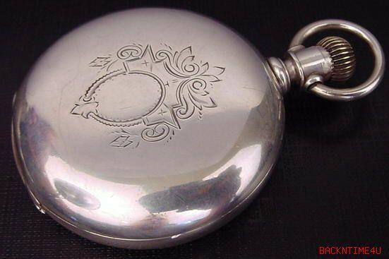

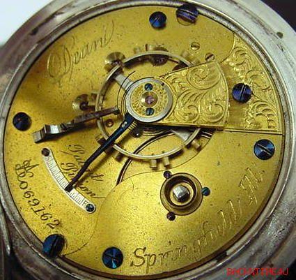

This is an Illinois Dean, hunter-case watch purchased on eBay, that arrived today. Snyder’s database says that it was produced in 1878 as part of a single run of 300 movements. It is key-wind. I think it is also stem-wind as a “transitional” movement. I asked the seller to try and wind it and he said that he did put about 3 turns of wind on it before it stopped responding. The case is not a key-wind case and the lack of case screw marks suggests that it may be original AND stem-wound. It will not stem-wind right now and I'd have to uncase it to see if it really is transitional, at this point.
Shugart has it at two-stars, although….. based upon his system, a watch of under 350 production, should be three-stars.
I only paid $320.00 for it and I was surprised that I got it. The book value is not high but …. gee…. 300 production?
I haven’t had time to photograph it (photos are the sellers, off eBay) or to service it. It obviously needs cleaning and some attention (perhaps) to the wind mechanism.

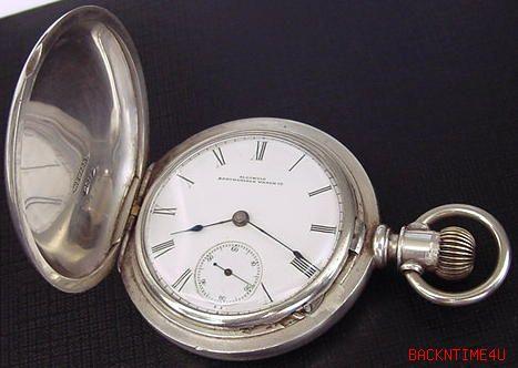

Dial has just one tiny hairline although it is nothing special. In fact, the "Dean" was not a particularly fancy watch, unadjusted and without frills.

The case, in my opinion, is great.... especially for the price. It is what first attracted me to the watch. It is worn but not badly. It still has very clear, simple engraving. The covers all snap shut, opening mechanism is working fine and the covers open to 90 degrees. It is coin-silver and feels like at least 4oz.
If the movement IS transitional, this case might arguably be original to the watch. Even as just an empty case, I would think that it is easily worth more than $100.00 alone.

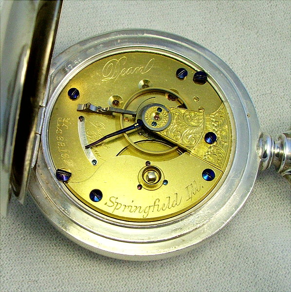

I "restored" this watch last week. My intention was to service the movement and to do minimal cleaning to the case and dial.
The case was lightly buffed to make it look cleaner but still old. That came out nice.
The dial looks free of hairlines and it was simply soaked a bit to clean it.
The movement was cleaned in the ordinary way. In reassembling it, I made a stupid, stupid mistake and badly bent the pallet pivot. A few phone calls told me that I would NOT easily find a replacement. So... Galen Gudenkauf MADE an entire new pallet-pinion out of steel stock. When I returned to the shop, the train was assembled and running free.
I then finished assembly and was shocked to find that we were able to time it, in four positions, to +2 beats (in two) and -1 beat (in two). That's RR Standards in an old watch that was manufactured as unadjusted. And... it is running with an entirely new pallet-pinion. I'm in awe of those kinds of watchmaking skills.
I was also superpleased at how the movment cleaned. The plates, free of dirt, now look almost brand new. With a total production of only 300, hard use and almost 130 yrs, I can't imagine that there are many survivors in this condition.

Inside the movement, I found that a winding spring was broken. This spring pushes the winding mechanism back into "wind" position after the lever has moved it to "set." The other end of the spring powers the click. I also found that the rachet-gear had a broken tooth and that the primary winding wheel had slightly rough teeth (wonder why?).
I was able to replace the spring with one from a parts-watch of similar age. I was unable to find a rachet gear with precisely the same configuration, so I kept the one I had, broken tooth and all. Likewise the winding gear which I doused with a liberal amount of watch-grease and my best wishes!
The result is that the watch has been restored to full-transitional winding, albeit just a tad rough. Old watches do force compromises.
