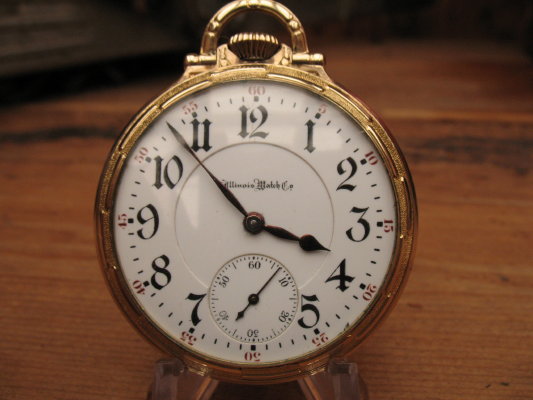

This showed up inside a Sangamo Special Rigid Bow Case last year at very little extra over the case cost. Lo and Behold this is on a "Par" of rarity with the Sangamo Specials!
May 30, 2009, 01:59
While the dial is less than perfect, it is correct according to the description. I did find an appropriate case for it.

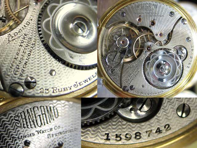

The movement took some work, and special treatment of the Balance wheel, but it is as close to 6 positions now as it may have ever been. (Whew) This is from the last run of 400 pieces with a total of 2690 made. Among those few done, there are pattern changes and also the prized Pennsylvania Specials as well, so every one of these is "special" in its own right. That is why I took extra special care with the movement and getting all the parts in order as they should be. As most of you know, I remain convinced that the Getty design was a pinnacle of American Horologic design in its own right.
I guess the "jewel race" of 1901 was sorta like who could make the most Garish Tailfins on late 1950's Automobiles. Because the Getty motor winding mechanism does not easily permit a Jeweled Going Motor Barrel, to make 23 jewels Illinois added 3 pairs (6 jewels) of caps to the pivots for the Pallet Fork, Escape and third wheels, making this an extra "dustproofed" super-tuned 17 Jewel movement.

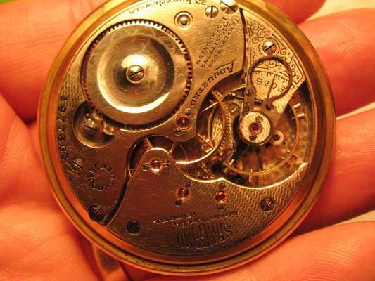

David, I have one of these 23j Gettys as well. Different case and mine has an ugly metal dial. Are these rare? I post a poor photo as it is not in good light conditions.

Mike I show that yours was made in 1907 & that there were a total of 1160 made from 1906-1909, yours is listed as bright spotted third pattern.

Tom, Thank You for the extra explanation about Mike's Watch. As you noted, Mikes enjoyed a run of 1160 and mine had a run of 2690. The computer data file I used allows a very detailed review of each movement type, while the Blue book allows you to scan the movement groupings of watches.
The difference that I learned from studying the Blue book is important to add as a correction to my post on this. There are two groups of 23 Jewel Sangamo Open Face Movments; Mikes is a Double Roller movement and mine is a single roller movement that is grouped into 5 different Variants, including the "Pennsylvania Special" which actually came from the same 400 piece run that mine was in.
These are all very rare with a combined total of only 3850 made. Grouped, they are 1 star and separately 2-3 star.

I wonder if that run of 400 that yours was in was a mixed run with the "Pensylvania Special" as it has no markings on it to declare it as such. You would have thought they would have marked at least the movement if not the dial as well. I wonder if they were marked, just how many left the factory with the P/S ID. They only came out of your run so where are the others? If there are marked ones they are rare birds indeed.
Steve
June 02, 2009, 22:15
Steve
I think that was a mixed run, it was 1598601-159900, 400 of them & some but I have no idea how many were the P.S.

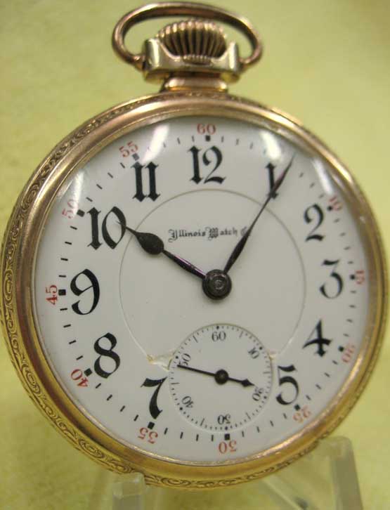

David, and Lindell, here is the watch we have discussed. 23j Getty with the correct dial. Lin, as we discussed, this is not the correct/original case, nor are the hands original in my opinion. But, this makes an awfully nice addition to my collection. The old metal dial is UGLY!

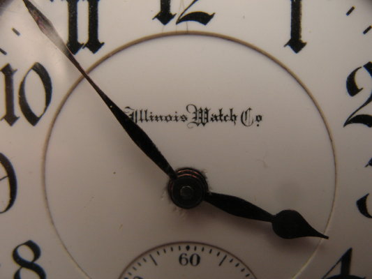

Closer look

Mike, "Ya Did Good!"
