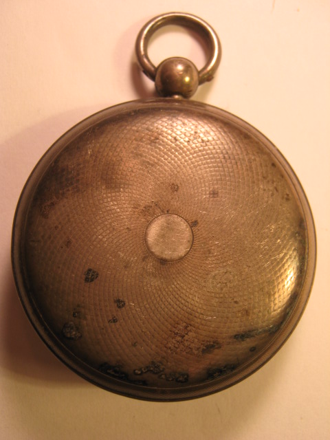

Any thoughts on the ID of this watch
https://ihc185.infopop.cc/eve/forums/a/tpc/f/1086047761/m/2423951777
February 11, 2013, 21:35
Jon Hart
Thoughts???
It has a cable winding system
Could it be as old at 1600-1650?
Jon Hart
2
February 12, 2013, 01:15
Gerald Zimmermann

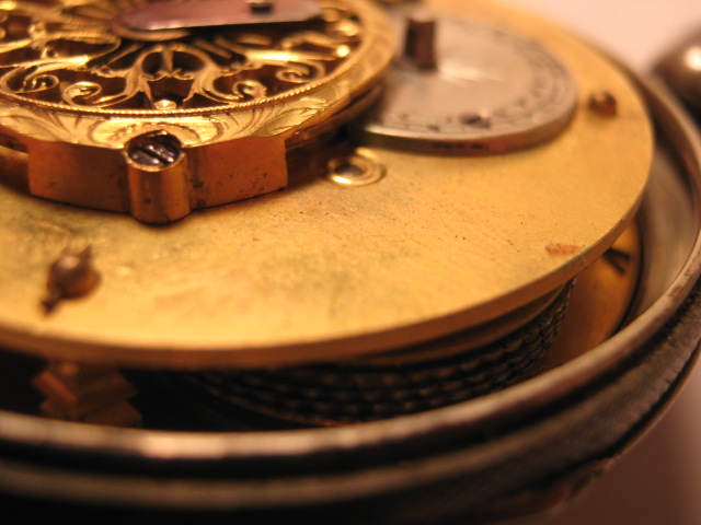

First thoughts:
French verge fusee, Japy Freres ebauche ca. 1820.
Good dial and hands ! French fusees are wound from the front side, this causes often terrible chips near the winding arbor.
Are there any marks at the case and could you show a side view of the movement ?

Gerald - First nice to see someone actually help out... Big Grin
Let me get some additional photos
I sent the 2 photos to a friend and his thoughts:
"These verge movements are super hard to identify when they are not signed. I think it may be French in or-gin but there is a chance it is Swiss. Hard to tell! I think the case is French. Made around 1810-1820"

February 13, 2013, 04:34
Gerald Zimmermann
I agree the part with the 'super hard' Big Grin
The small mark on the right side is called:
'Chevrons de Neuchatel' used since 1814. - swiss
Japy Freres, which I think were the maker of the ebauche ('rough' or 'gray' movement), were located at Beaucourt - france
For an unmarked verge we are getting it real close.
Gerald
