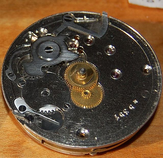

Here's a recent acquisition that has some problems. I'm trying to decide on repairing or selling.
Grade: 89 Movement Ser Number:1635357 Est.Production Year: 1902
Run Quantity: 10 18s 17j Hunting Nickel Two Tone
Model 5 Lever Set Full Plate going barrel fast train
Adjusted to 3 Positions Adjusted to Temperature: Yes
Railroad Grade: Yes
I've determined so far that the balance staff is broken, missing roller jewel and also part of the micro-regulator.
On the bright side the movement has nice color, no scratches or rust.
Anyone have balance parts for this movement?

Dave Turner
Dial side:

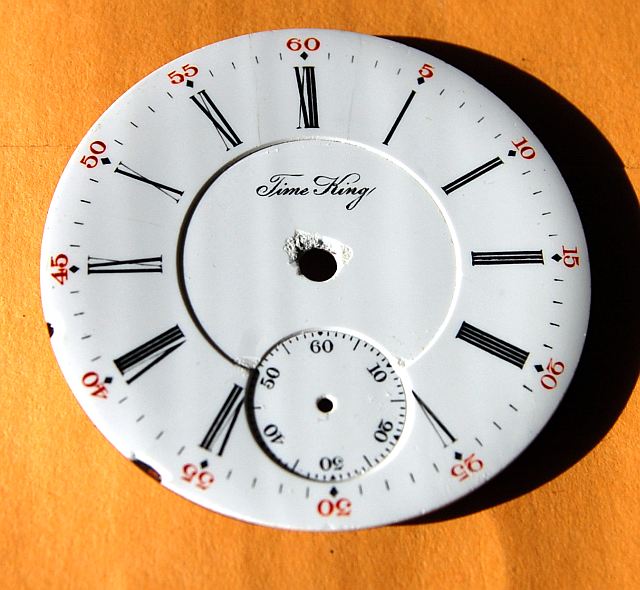

Dave Turner
Dial (needs a little work)

The Staff and Roller Jewel are no big deal, the regulator spring is something that can wait for a parts movement. When do you want to start?
