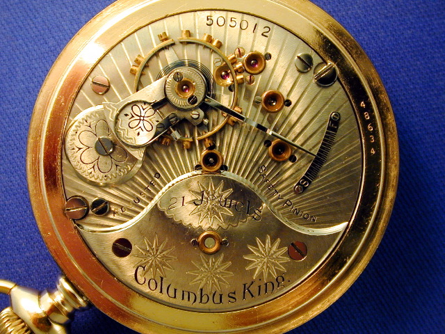

Not Ignorance but a healthy curiosity! We've all heard that curiosity killed the cat but I'd say our favorite pup is accumulating knowledge. In fact we're all learning something new every day.
Serial Number 505012 is a fully adjusted for RR Time Service 21-jewel Columbus King...

Stu Goldstein
Wow! that’s a good-looking movement Lindell! According to Shugart’s Columbus section only the Columbus Kings and the Railway Kings had the happy combination of raised gold jewel settings (raised gold jewel settings strike me as textural, form-following-function) and no two-toning (two-toning strikes me as gaudy, form-unrelated-to-function).

Steve Maddox
Just because a watch has a Breguet hairspring and a good quality mainspring, does not mean it's been adjusted for isochronism. Such a watch would probably have the POTENTIAL to be adjusted for isochronism, but that doesn't mean someone has actually taken the time to adjust it.
In watches with Breguet hairsprings, isochronal adjustment is accomplished primarily by changing the shape of the overcoil. Generally speaking, bringing an overcoil closer to the center axis (staff) will increase the rate when the balance amplitude is low, while moving the overcoil more toward the perimeter will have the opposite effect. Unfortunately, every balance and hairspring is different, so that each has to be individually adjusted if highly accurate rates are expected.
In watches with flat hairsprings, isochronal adjustment is accomplished primarily by manipulation of the regulator pins. Wide spacing between the regulator pins will tend to allow slower rates when balance amplitude is low, while minimal space between the regulator pins will tend to have the opposite effect.
For what it's worth, I have a 23j RWK, and like Lindell's Time King in the image above, it does not have gold jewel settings. I've always wondered about the reasons for that, but I'm not sure ANY Columbus watches ever had gold jewel settings.

Regarding gold jewel settings I was just parroting “GJS” from Shugart. Maybe there should be another designation like say “GCJS” for gold-colored jewel settings?
April 12, 2003, 07:31
Steve Maddox
Real gold jewel settings (as well as balance screws, train wheels, etc.) usually have a distinct pink color, and they're always highly polished.
In an attempt to imitate the appearance of gold settings and balance screws, some companies used a copper alloy that can be polished to look like gold, but in time, it loses its lustre.
