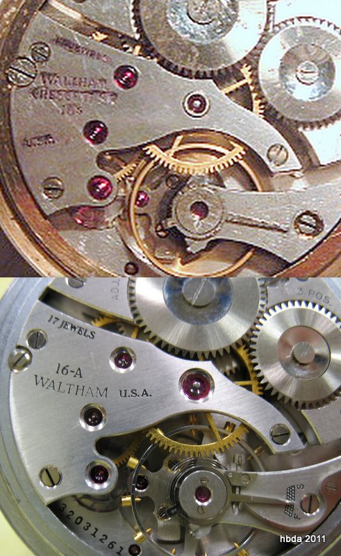

For comparison, I took out a pair of 9 and 17 Jewel "16xx" series Walthams. Both of these are WWII vintage production with the 9 Jewel issued to a British military unit and the 17J used (evidently) in the Pacific conflict.
January 09, 2011, 15:15
Mike LaForest
Roger,
The serial number you gave for this watch does key-out to be a 9 jewel (1908 model, unadjusted) movement, and the serial number shows to be grade 1609. It should not be showing so many jewels. Perhaps it was upjeweled by a previous owner? Or, perhaps it is a 'Frankenwatch'. I rejoice with you that it is keeping such great time; it is a perfect watch to carry.
Mike
M.
January 09, 2011, 15:26
Then I compared your "9-17" Jewelled watch with my 17 Jewel. Before starting that comparison please note that the 9 Jewel in my first picture is actually signed "Premier" which is quite out of the ordinary for any 9 Jewel watch to be named, so Naming yours Crescent Street may have been more arbirtrary as well.
Coming to your 17 Jewel movement vs mine, the much larger "stock" size Jewels pressed into non-countersunk holes on yours appear to have been re-fitted to the watch by an up-jewelling that could easily have been done at a watch school. That is further evidenced by the lack of any micro-regulator on yours. While the factory records of some Waltham Production were scrambled, during the War Waltham took extra measures to maintain accuracy of records. So I would agree with Mike that yours is an "up-Jewelled" 1609 type. It scould be considered a "student" watch and to that end is more collectible.
