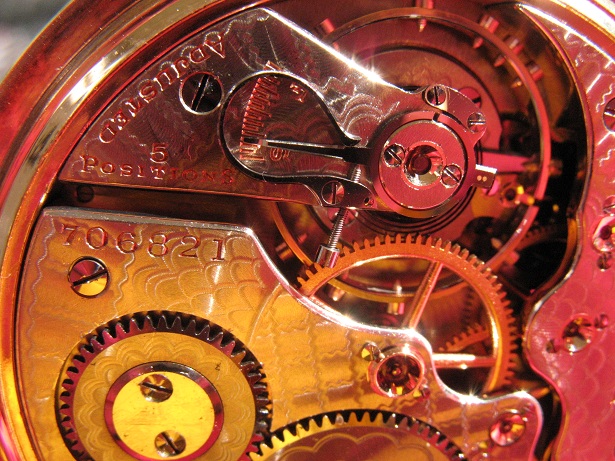

some detail

Mike,
Jazzy movements like this one are hard to photograph Cool you did fine.
Total production on the 990 is just over 16,000 as compared to nearly 550,000 when adding up all the 992 variants. As Claude pointed out these are finely finished premium quality watches and of course as a bonus number 706821 can also be expected to have a four foot dial.
One thing more, the "Ball Model" case is not original to the movement, most collectors would use it for a Ball-Waltham as there are apparent case-screw marks from a Ball-Waltham movement showing most notably by the "C" of "Hamilton Watch Co." on the train bridge.

Actually I have a Ball Waltham that needs a correct case and will remove it from its current case and simply swap them. Then they will both be housed in correct cases although not original cases.
