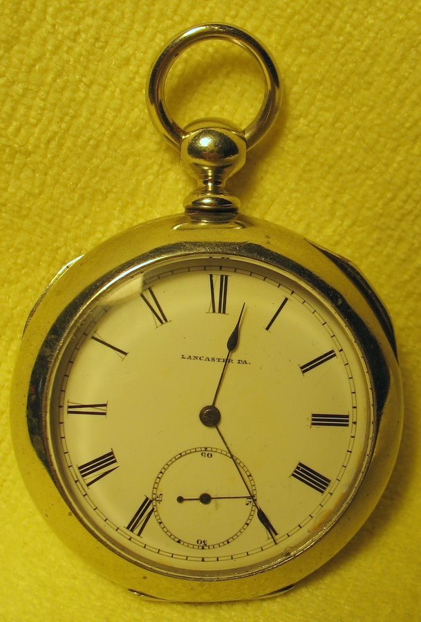

David AbbeThis is a Lancaster "New Era" KWKS that I did rercently and posted
April 04, 2009, 20:08
David AbbeThe movement has the "beginnings" of Hamilton stuff with a "full circle" Pallet Bridge

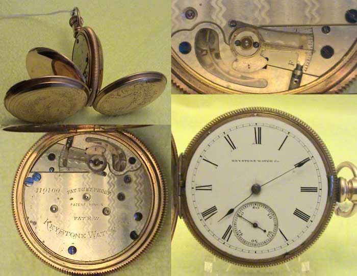

David AbbeWell . . Tonight I got this disassembly going of the "Dustproof" Keystone.
When Steve posted his pictures of the "Dustproof", he mused; "I suppose the Aurora Company has as much claim as Lancaster, but neither of them resemble the later Hamiltons at all."
Steve, there are a couple common points with this to the Hamiltons after all. First . . . The Dust Ring is Fully Machined the same as Hamiltons were. This is quite unique to these watches as most dust rings were cheaper stamped and rolled method parts . . .
April 08, 2009, 23:55
David AbbeThe other most obvious "signature" part of the family to become "Hamilton" is the Pallet Bridge (or "cock") which is a full circle ring, quite uniquely Keystone/Lancaster/Hamilton . . .
April 08, 2009, 23:57
David AbbeSwing out Dust Cap for the Balance wheel has a Cold Solderd in Mica "Window', Cute, Expensive and fundamentally a waste of money except to advertise it is there.
April 09, 2009, 00:05
David AbbeAs the Pallet Staff is Not Jeweled, this is a ten (10) Jewel movement, with 1 Roller Pin, 2 Balance staff Pivots, 2 Balance Staff Caps, two Pallet Stones, and 3 pressed in "Swiss" friction Jewels (mostly for show).

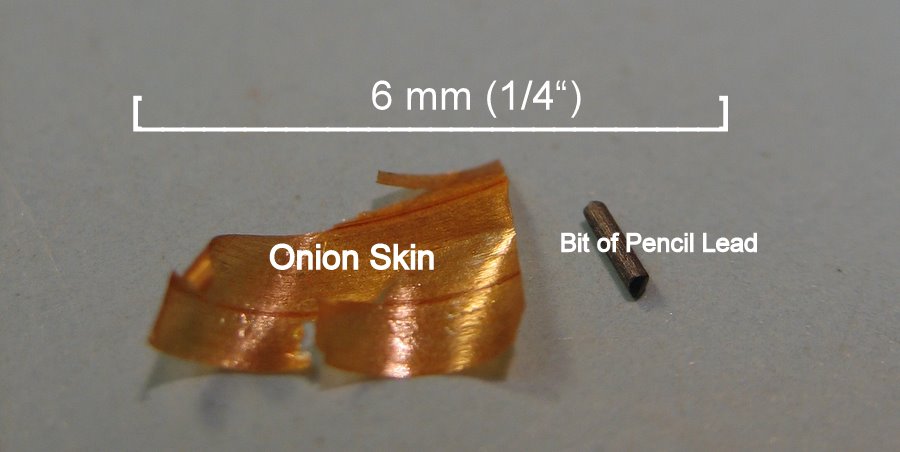

David AbbeOh, I found a couple other things left inside the movement by the last service person.
Maybe they were reassembling it during lunch time.
I expect to report the reassembly later this week, but have no plans to re-use these two "parts".

April 12, 2009, 18:48
David AbbeNow comes the "Put Together" part . . .
Firstly, more odd notes, a three-piece "SCREW-TOGETHER" Pallet Fork!(first one for me that actually used a screw!)

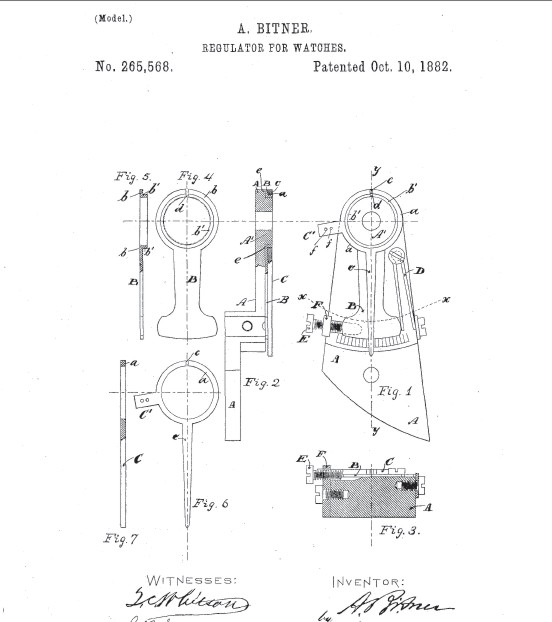

Then there is the strange Balance Cock Regulator that is actually "just like the pictures" in the Patent! Ugly and complicated!
In re-assembly, the wheel train turns out to actually be a 16 size. About the only "big part" is the motor.
Oddly in this watch it is safer to place and assemble the Pallet Fork/Bridge set before putting down the top plate!
All in all, I would bet that there were many watch makers who charge a premium cleaning fee for the Keystone "dustless! It takes about twice the time as "normal".
April 12, 2009, 18:51

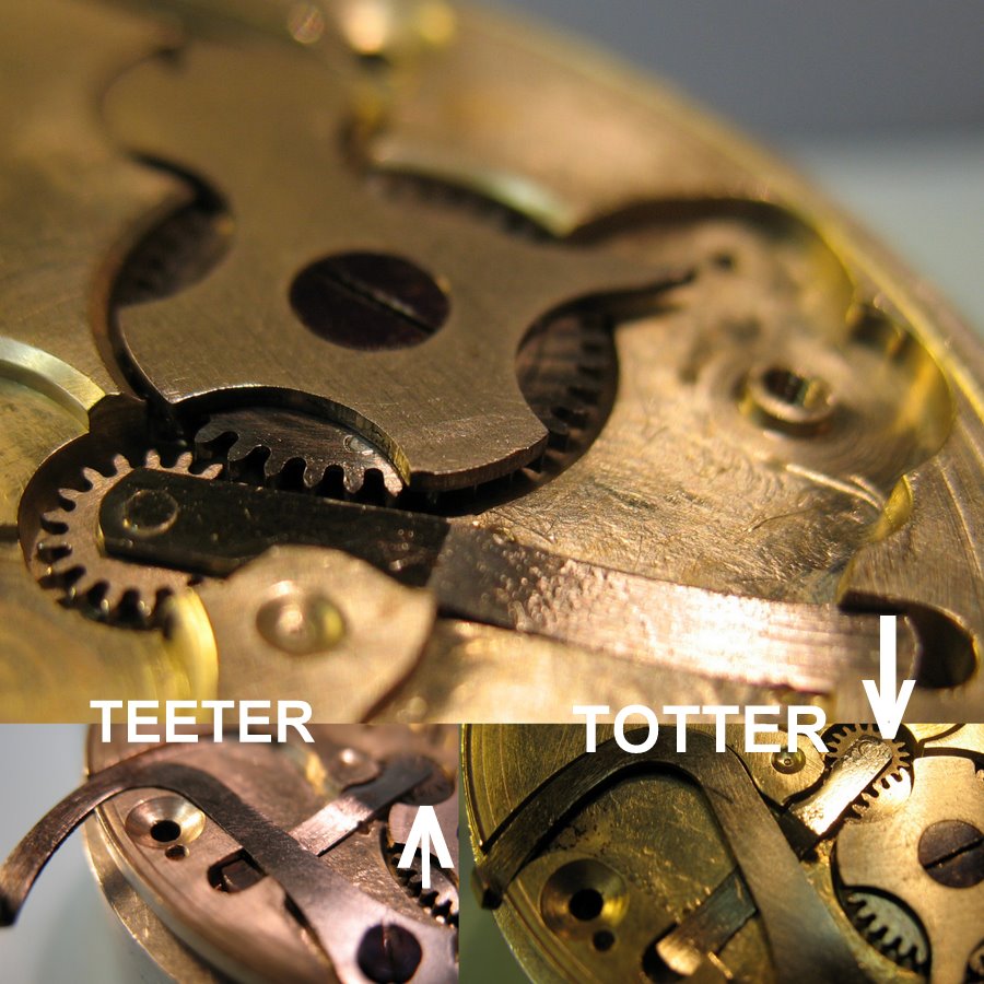

David AbbeOn the "wind and set side" it is completely different from any other I have seen, and easier to reassemble. It uses a very unique "Teeter-Totter" rocking bar mounted transfer wheel to engage the time setting.
April 12, 2009, 18:53

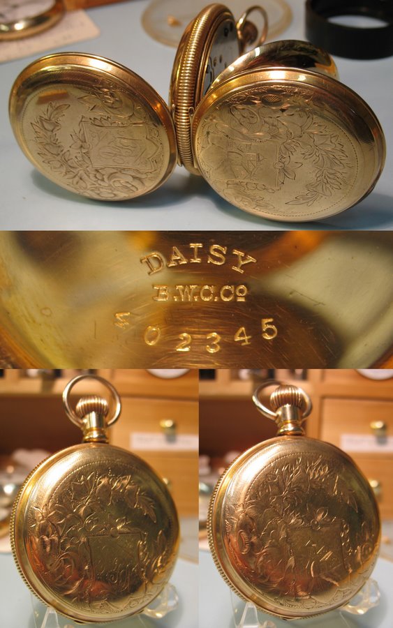

David AbbeIt goes together very nicely in the (what looks to be) original "Daisy" Hunter Case
April 12, 2009, 18:55
David AbbeDon't ask me how, but two years ago, I got this (somewhere
) for $38.00.
A swell deal after a couple hours work to clean it up and get it running.

Steve GossardWhat a beautiful watch! I'd bet that was the highest grade they made. What do you think?
April 13, 2009, 12:58
Jerry KingDave, what turns out to be a super looking watch....As they say....
From out of the ashes comes....
Great job on another restoration piece....
April 13, 2009, 14:40
David AbbeSteve and Jerry, I agree, it turned out beautifully and will remain with my personal "stash" as representative of that phase of watch evolution. A watch that had all the disadvantages of an early full plate movement including full disassembly to replace the mainspring. Plus added design features that made the "3/4 plate" design laborious and hazardous to service.
That must explain the short life of this particular watch movement.
All that said, it keeps darn good time and is reeeeeel purdy!
