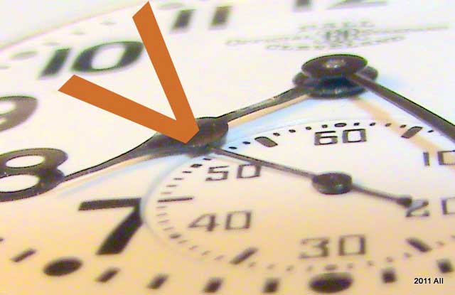

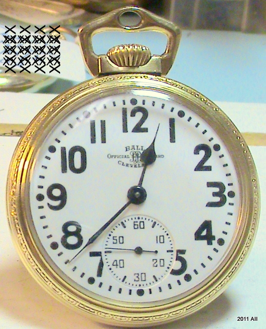

Sometimes we send out a nice all cleaned up fixed and timed watch only to get the little beauty back with a note telling us it "STOPS", so we go to the bench, set down and look at it . . .
November 16, 2011, 16:53
David AbbeThen we look a little closer and AHA! . . . the Hour hand shifted ever so little and can YOU see what that did?
November 16, 2011, 17:00
David AbbeAfter some "precision tweezing" all the hands clear each other fine. Will they stay that way? Probably for awhile . . .
Rule #1 when your watch stops (and is is wound), L@@K for any interference between hands, this CAN be seconds hand to Hour Hand or Minute Hand to Hour hand. If you see that and it is the seconds hand take a flat toothpick and lever the hour hand up slightly. If it is the minute hand, put the watch in "set" and back off the minute hand from the hour hand . . . THEN do the toothpick to the minute hand so it is just slightly higher and clears the hour hand.
When you are done, everything will be "Hunky Dory" again and you do not have to scare the heck out of your watch fixin friend with a return that "stops running".
