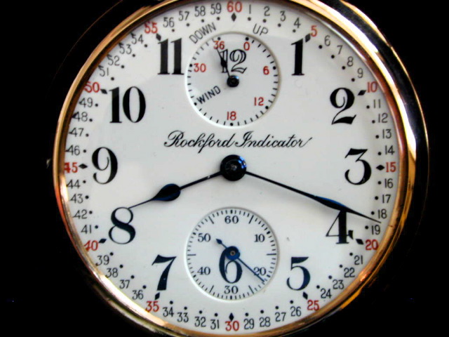

That said, it seems to me that Rockford Wind Indicator dials are more problematic than any other that readily come to mind. Since I like those watches, I tend to notice them, and of the 40 or 50 I've seen in my life, I don't think I've seen more than two or three with perfect dials. Of course, there again, my observations are probably biased because the watches I've seen have been in the market, and may not necessarily be representative of all existing examples.

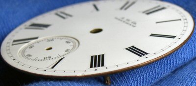

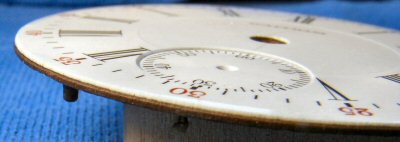

Larry SoucheckSome are just thinner than others. On the left, Hampden. This seems a typical thickness of most dials I've looked at. On the right, Seth Thomas. Very thin. I don't know if this would have any effect though.

Larry Soucheckfaces

Rockford Indicator dials are among the all-time greats... and of course the RG 655 movement's no slouch either!

Stu GoldsteinLarry’s photos are really interesting! Not only is the Hampden
thicker; its edge is so much more
finely finished – smoothed and chamfered. How did they do it? Do Hamiltons, Walthams, Elgins look like this Hampden? Is there a difference among
grades within a given maker? This is good stuff!

Wayne C. AndersonWaltham painted dial edge.

Wayne C. AndersonWaltham dial porcelain.

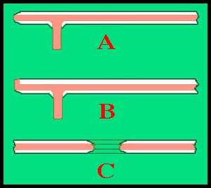

Steve MaddoxWhen enamel is hot, it essentially becomes a viscous liquid, with all the flow properties pertaining thereto. When the liquid encounters a surface irregularity (such as the edge of the dial or a dial foot), surface tension draws the enamel upward or downward for a short distance. I don't imagine many people will have the foggiest idea what I'm talking about, but perhaps the sketch below will help explain it.
The copper bases upon which most porcelain dials are fired, are relatively thin. Of the overall thickness of the dial, the copper portion seldom composes more than 10 to 20%. To prevent the enamel from drawing thin near the holes, those are cut last, after the enamel is finished, and to prevent it from drawing thin near the edge, a "lip" is formed around the perimeter. By looking at such a dial from the edge, it's easy to get the impression that the copper is much thicker than it is, but that's only at the edge. Again, the sketch below should be much more explanatory than words.
In figure "A," a cheap dial is shown in cross section. Note how the copper base is flat, and how the enamel has receded near the edge, thereby leaving a thin curved portion at the perimeter. In figure "B," however, the lip around the perimeter of the copper base allows the hot enamel to flow up the edge, thereby taking advantage of the surface tension to create a dial surface that's almost perfectly flat. In figure "C," a hole is shown which was drilled before the dial was fired; again, the enamel has receded from the edges of the hole, thereby leaving a surface that isn't flat. Many porcelain dials on cheap watches (Ingersoll Reliance models, etc.) have this characteristic.
Finally, note how the enamel tends to "gather" around the dial feet; again, this is the result of simple surface tension.

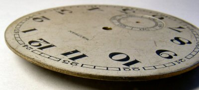

Wayne C. AndersonHere is a Waltham dial that I believe matches Figure B in Steve Maddox's drawing. Its an early model 16size dial.

Steve MaddoxDog -- I honestly don't know how the Hampden dial in Larry's images above was produced, but it's apparent that the perimeter has been "ground" to finished size. That was a common practice, but I don't have a dial like it here that's suitable to be destroyed in order to find out how it was made.
One reason that particular dial thicker than most is probably because it's a "glass enamel" dial, which is essentially a porcelain dial with a clear coat of glass over the top. That's how the metallic crescent-shaped pieces show through, yet are not raised above the dial's surface.
Other reasons some dials are thicker around the edge is due to the various "sunk" sections. Obviously, in order to create a double-sunk dial in which all three sections are level on the back, the outer ring has to be thicker than the center, and the center has to be thicker than the seconds register. It's hard to tell for sure about Larry's ST dial, but it looks like a "pseudo double-sunk" dial, which is essentially just a single-sunk dial with a ground circular part in the middle to create the appearance of being "double-sunk."
Wayne -- The dial in your image does match illustration "B" in the sketch above. If you'll closely examine the chip in the edge near the 21 minute mark, you should be able to see the raised rim of the copper base that I mentioned.
