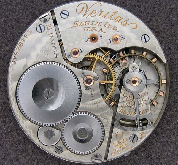

I was just joking. I knew you meant that in good humor. The watch has arrived and I've taken a look at it. The hands were rusted and the case so brassed and beaten that I was elated to see how nice the movement and dial are. I've included some pictures if anyone is interested.

A great, rare Elgin. Are the Hands still usable? That is if you soak them in my "secret" rust remover (see pic), then re-polish, and re-blue them)
With an Elgin "Honest" (w/the 6) Montgomery Dial like that who needs a case? Beautiful. I would go through that movement with utmost TLC, it looks like it has seen some service. The gold timing screws are run all the way in which may explain some of the reason the regulator is set over to the slow side.

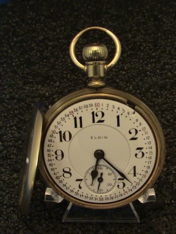

Before . . .
March 16, 2008, 18:54
After (btw, This is the Elgin Montgomery dial they could skip the 25 cent royalty payment for by deleting the 6 that you have on your mint dial)

Thanks for all the pics and tips, David. One of the hands actually was rusted enough to have some flea bites out of the edge so I'm going to be hunting up some more. Funny that there wasn't much rust staining to the dial. I'll be sending this one to Chris Abell eventually since I've reached the limit of my skill set.

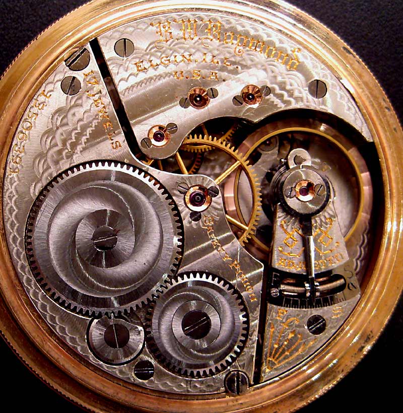

But the one that seems to be really tough to get is the 17J 361 grade-1000 production. Although it is not a Veritas Grade, and seems to only be found as an B.W. Raymond. It is really strange that Elgin (+50,000,000 Total Production!)would make short runs of High grade watches...Just doesn't add up???
Here is a shot of the 361 grade, have had it for a while. but never have done the service.
