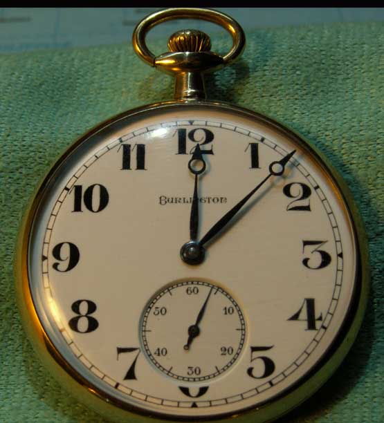

I purchased a 1917 Burlington (by Illinois) 12s 21J Pocket Watch that neeeded some work, including a new mainspring. When it arrived, I was very pleased, especially with the condition of the case. Like a number of you, I believe that a lot of the high quality 12s P/Watches are well underpriced for their performance and finish!

SmileSo fully disassembled movement and cleaned in my little Ultrasolic machine with L&R Fluids. Carefully inspected -THANKS Chris Abell for the checklist! Fitted new M/S and dipped H/Spring. Assembled movement - started up straight away...
Re-fitted to case - keeping great time straight up! THIS ONE LOOKS LIKE A KEEPER!!
So took it out for a walk (on my 1890 Simmons Chain) - No probs. Time right on....
The next day FOUND HAD STOPPED DURING THE NIGHT!! Upon careful inspection, found that there was no power to the Fork! Pulled the Balance, and put aside. Removed the Escape/4th Wheel Bridge:
OUT FELL A TIMING SCREW!! Looked at the Balance - sure enough one missing! Just as well I did not try to turn the wheels with the screw stuck in there!!
The screw on the opposite side was loose too! The thread fit was not really great, but they did up again OK.
CHRIS ABELL - Might have something to add to your venerable Check List : Check Balance Timing Screws for tightness.
