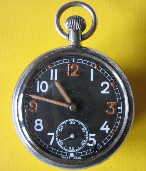

Peter DragoThis thread got my attention so I took my Ion Chamber radiation detector and measured the radiation level of this watch at close proximity. The level came out at 6mR (milliroentgen),about 1600 times the allowed safe background limit.This will not pose any danger if the watch is kept in a display case and out of touch, but I wouldn't advise carrying it in your pants pockets for any lenght of time.

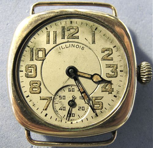

Bruce StewartThat's exactly why I won't wear an old wrist watch with radium. I am a cancer survivor and don't really want to take a chance. Attached is a picture of my Illinois Lady Stewart wrist watch that I posted last week with the "Tom Harned" inscription on the back. This is the before shot of the dial.

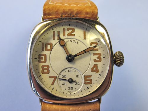

Bruce StewartThis is the "after" shot. I just finished this yesterday. I soaked the dial in Comet Cleanser for about an hour. Then I took a relatively stiff paint brush and brushed away the radium from the numbers. After that I immediately dump the cleaning fluid and rinse out the jar. Then, using acrylic paint, I carefully repaint the numbers. For the hands, I removed the radium, put a piece of tape on the front of the hands, then fill in the gap with acrylic paint from the back. Filling the void in the hands takes several applications. When paint has dried, remove the tape from the front. These hand turned out a little sloppy compared to others I have done. The next image shows a cleaner job with a different color of make-believe radium.

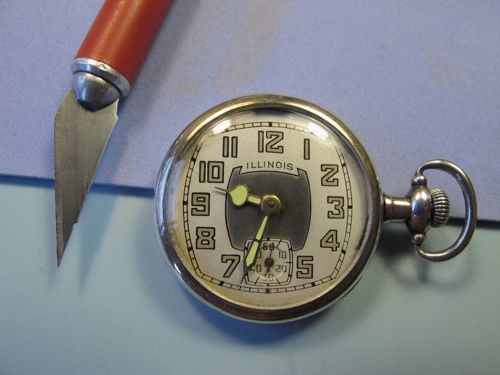

Bruce StewartThis photo shows a little Illinois pocket watch that I restored. For the hands on this watch I chose a different radium color (I noticed about 3 distinct colors for old radium -- an ivory color, a greenish color, and a brownish color). On the previous watch I went with a brownish color for the numbers to match the darkened color of the radium that was originally in the hands. I felt it also went well with the new pig skin strap. With these changes to the dial and hands, I feel much more comfortable wearing my old wrist watches.

Peter DragoHI Jerry, thanks for the comment. The watch is a general purpose Swiss made,15J, WW2 military model from the early forties, I presume. In the back there is the usual G.S.T.P. crowfoot and the number M29835
I would like to tell people not to panic because they have watches with suspicious luminous dials and hands,the great majority of them uses the harmless phosphorus compounds and are perfectly safe.
I checked all my military watches for radiation level, and, out of eight, only this one showed an abnormal amount. The only other one was a Waltham with a reading of 1.5 mR. It is also interesting to note that none of the military watches, radiating or not, glows any more in the dark.
The only way to know for sure is to actually check the watch with a radiation meter, a not too difficult instrument to come accross these days.
Incidentally, I have also some military radios from WW2 and their "luminous" dial markings and meter scales still emit quite a high level of radiation.

Ray HallenbeckWow Bruce, that's an excellent job you did repainting that dial, looks very good. I'm afraid I don't have the dexterity or the patience to do one of those. (Thank goodness for international dial Co.--
--Shameless plug there).
February 13, 2011, 20:42
Buster BeckTruly a professional job all the way Bruce
February 13, 2011, 22:13
Bruce StewartThanks guys for the compliments. That particular job gave me a sore neck. I definitely gave my new OptiVisor a good workout!! Concerning International Dial, I really like the work they do and have used them for several dials. On this Illinois, though, I wanted the background to remain original and just wanted to get rid of the radium (plus, I was super anxious to finish the watch so I could start wearing it

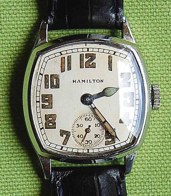

Dave TurnerI find this an interesting post, especially the refinishing job that Bruce did.
I have this nice old 1927 Hamilton plain cushion case that is very reliable and keeps accurate time. I've been wearing it a little off and on lately, and plan to have the hands refinished and leave the dial as is. But now the radium issue concerns me a little.
First question I have is, can this dial be soaked in comet without destroying the painted dial? I don't think so. So, Bruce how did you do that? And where do you get the paint to refinish?
Recommendations?
I was going to send it off for refinishing, but will wait for some answers.
Dave
