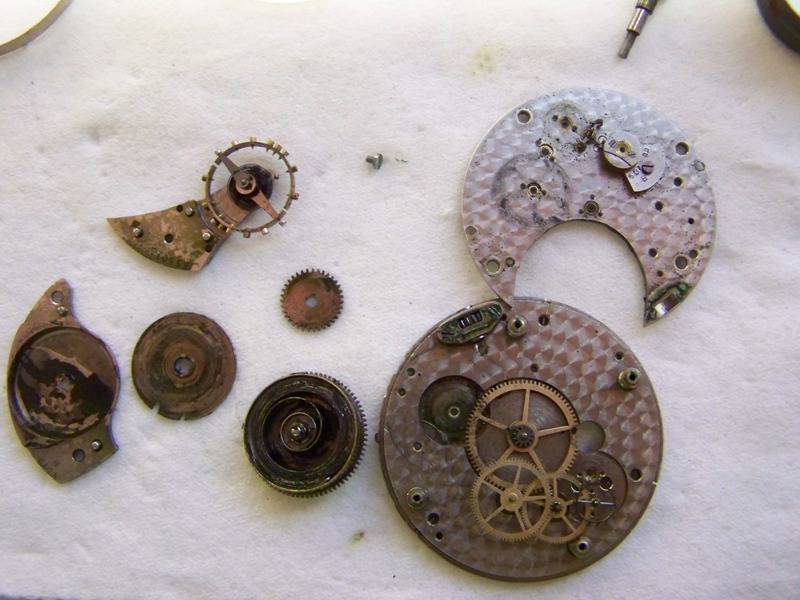

Last week I picked up a earlier Ham 975 what caught my interest was it was completely solid with thick green grease everywhere I mean everywhere never seen one so packed with grease even the hairspring was clogged solid hard. I stripped and after numerous operations removed the grease, as I thought it had escaped abuse and hacking all those years its been used for a while until someone packed it full of grease and left it well alone, very little wear to be found, of course some rust spots you can see in the ratchet wheel I am sure I could find a replacement to finish this off. It came with a PL I may put back on if this dial is considered incorrect. Well I decided to put sometime in for fun on the timing side see how well these old watches could have ran “back in the day” and it came out great as you can see not bad for a 1903 975.

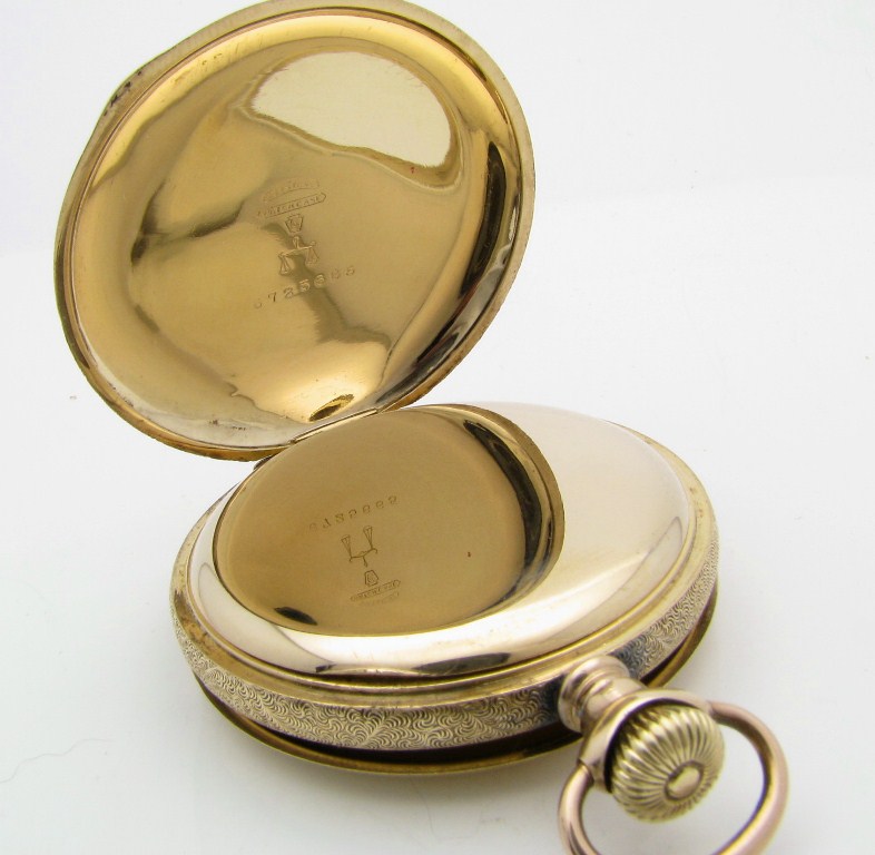

Nice "extra case" also

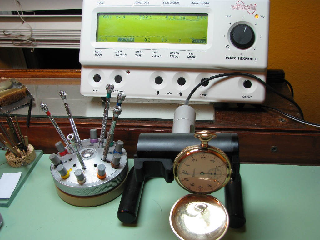

+1 s/d
www.Abellwatchmakers.com
July 01, 2012, 19:23
Chris Abell
0 s/d
July 01, 2012, 19:24
Chris Abell
pu
Chris Abell
PL
July 01, 2012, 19:25
Chris Abell
pr I also did PD but lost to photo still spot on

Very nice job Chris and I think pretty much answers the question about what one should expect in the way of accuracy from a non railroad grade watch .....in five positions none the less. Modern electronics (technology) makes easier work of timing a watch.

Just to help explain what Chris is talking about on the green grease, here is a pic of an 18s 21j South Bend I recently aquired. It is everywhere and took me about 4 hours of soaked, scrubbing, cleaning, etc. to get it removed. To say the least, the final watch is fine, but still a pain.

Jared that’s the goo, the only thing I can figure that someone must have poured a heavy oil in attempting to fix it then realizing what he had done slipped it in a draw to be forgot about, should of taken a photo, it was all over the gear train balance a solid mass, as I say wonderful to see literally preserved I get customers telling me that there 23j xyz will be a great timekeeper once serviced, that’s why they invested in a 21j/23J after reading all about the jewels and RR standards etc. I have to tell them that there is no guarantee at all how well it will run until I start taking it apart and see what damage from past “repairs” & lack of service, use and abuse has gone on, watches can apparently survive hundreds of years in good running order if looked after. I have had over the year some 0 size 7j watches run near perfect timekeepers, you never can tell and have to adjust out as much as possible with what you are given to work with. As all these watches are now old with history, jewel count means little, it gave them a better chance to survive in good order.

I would agree with you on the oil part. I just tore down a nice 18s Elgin Father time that looks to have been soaked in a jar of 3 in 1 household oil to try to get it running. Everything was drenched in it and as always collected in the tight spots and the hairspring was solid with it. This was done recently too as the main amounts oil were able to be removed with a dabbing of a paper towel before typical cleaning. I just cannot stress to enough people that soaking a pocket watch in 3 in 1 oil will not fix broken mainsprings or balance jewels either Big Grin (the real reason that the Father Time wasn't running)

Buster, so this dial is correct? as I say its one I had and fitted as a alternative to the PL it came with?

Chris I believe the Old English Hamilton dials were in vogue from 1908-1913.
Very nice looking watch !!
July 03, 2012, 11:59
Chris Abell
Thanks Buster, if I sell it will give the owner the option of the two.

To bump this once as a followup....I've been carrying this one for several weeks now, and it averages about 3 seconds slow a week. Not enough to go after, and WAY better than required for railroad accuracy.
