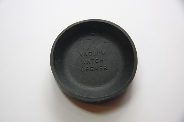

Istarted out using this.

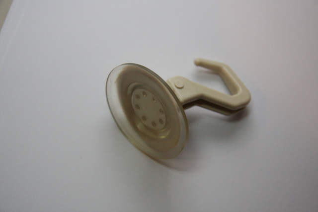

Then i found this.

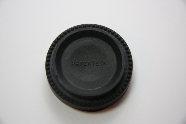

The smaller side, for the smaller watches.
