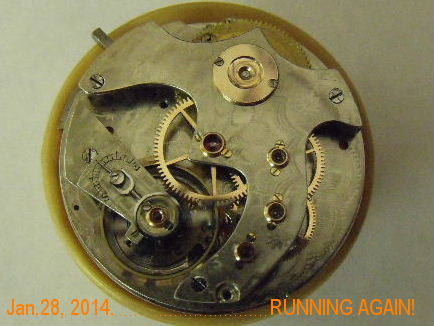

John Willis
HI; RECENT UPDATE!! The watch is now running!! After doing a lot of looking and measuring I determined ( balance wheel was from a model 1892.
(B balance staff was an original 1874 fitted with a double roller ( I assume that was original to the 1874 but have no info. on that. (C. spring barrel was original as was the MS.
I was fortunate to have a NOS spring in fine shape so it went in. The balance staff was purchased from Dash 2.
I just finished putting in the staff and assembling the watch and it took of like a scaulded rabbit! It sure felt good to see it running. Has been a fun project to sort it out and get it running. I will add a couple more pics of it running and cleaned. I will a couple more on in a few days when I have cleaned the case and have it completed.

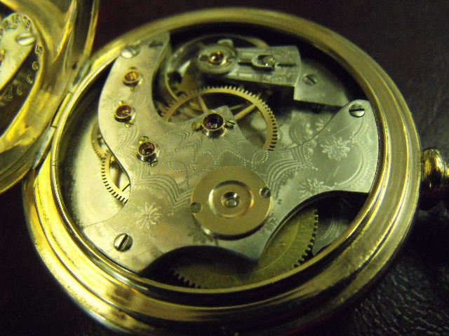

John Willis
Been a little tardy with my updates. I think it is finally finished. I had a little fun getting it to run well in all positions but after chasing ghosts for a while determined it was hairspring. To summarize:
Balance is from Waltham 1892 fitted to a staff from a Waltham 1874. I think hairspring, roller are 1874.
Main spring and barrel are original 1874.
Dial appears to be original 1874, not been altered and has all 3 posts. Unfortunately has some crazing at the post areas. I will look for a good replacement but probably not plentiful (Anybody!!!).
Case is ygf C.W.C Co. 314905 in decent condition. I fitted it with a new crystal and gave it a little rub and I think it looks pretty good. I will add a few more pics. Thank you to everyone who contributed and looked in.
