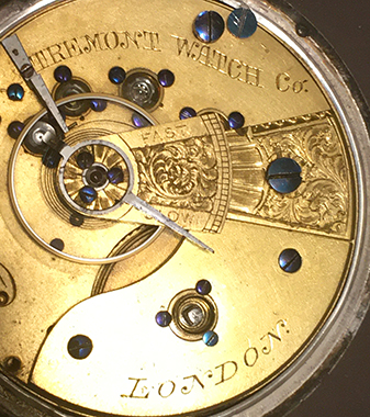

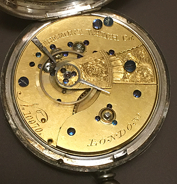

Here are some pictures of the London Tremont. Sorry about the regulator being off to one side I accidentally knocked it out of place when I took the picture. I have put it back in the center and it is almost a minute fast in 12 hours. I could adjust the regulator a little but since I don't carry my watches I will just leave it alone.

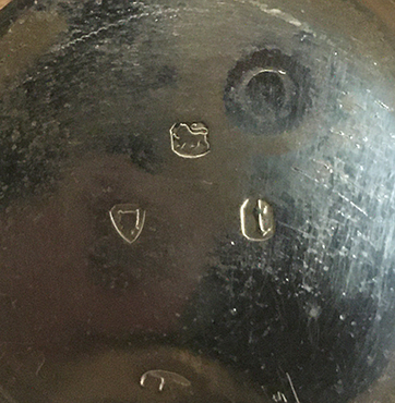

Hallmarks
