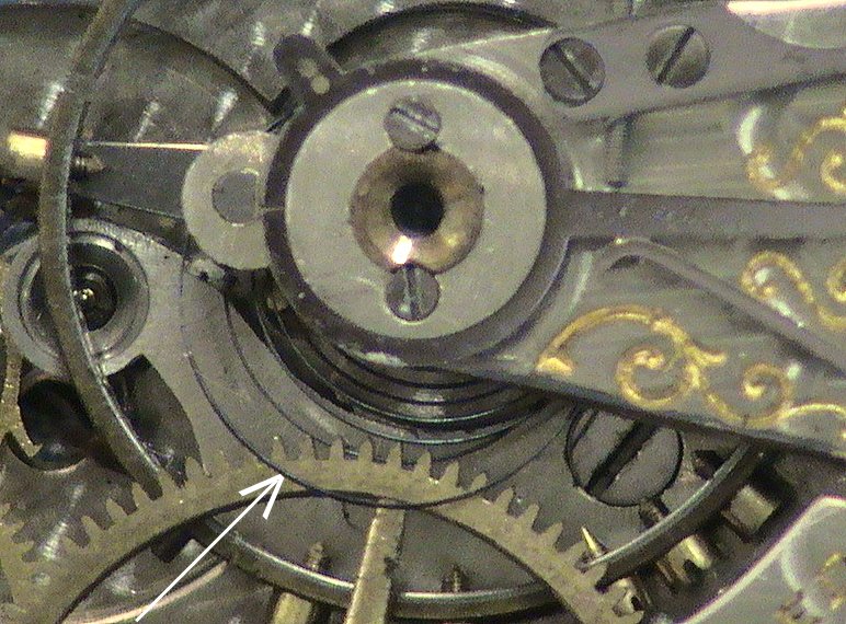

Terry as you said it "stops very quickly", you may actually have a simple problem of the Balance (hair) spring having jumped over the Center wheel (arrow) while doing the "St Vitus Dance" due to the demag operation. This is not uncommon for 3/4 plate movements, and as you did not describe your movement, I only suggest this as a possibility
April 15, 2009, 13:46
Terry Pitt
Hi Dave, it does seem to be overbanking, checked as you suggest and balance spring is correct, looks very good in terms of shape etc, perhaps doing the St Vitas dance did it some good. Big Grin
