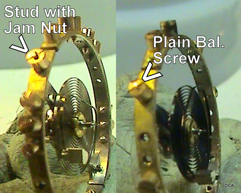

That was Elgin's idea of "mean time screws". They studded the wheel at 4 places 90 deg apart with threaded shafts. Screwed on those shafts should be slotted cylindrical Gold "nuts" to provide "mean time" adjustment of the watch.

David, Thanks for taking time to educate me on that subject. I think I remember reading that somewhere but can't place the source. When I get a junk wheel I strip it down and keep any usable parts such as the screws.
