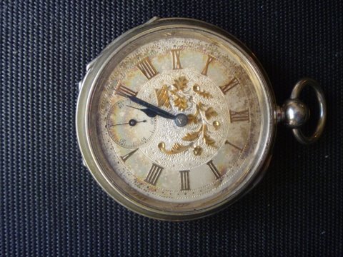

IDENTIFY: 24k Gold faced Pocket Watch
This pocket watch has 24K Gold Roman Numerals and a basket weave design in the center. It is a key wind with a double dust cover. The only numbers on the movement are 404523. No makers name anywhere. Any information would be appreciated.

Hi Alex, more pictures wold help us help you. Your camera should have a "macro" setting icon that looks like a little potted plant. If you engage that it will focus on a "flea's eyebrows". That will help you get some better pictures to show us this watch.

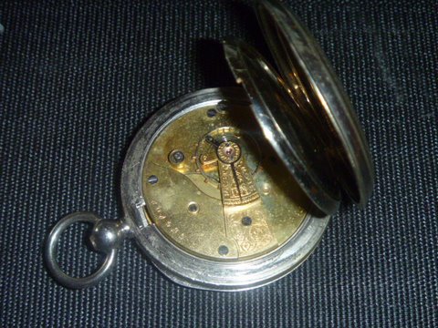

Here is the movenent...

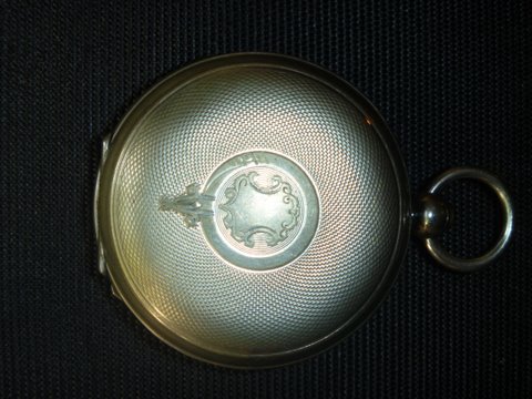

Reverse side of case...

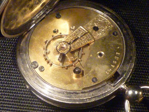

Hello David: Thank you very much for your suggestions on my picture taking. I wanted to add the 3 pictures that you now see, but in some manner I managed to add the one picture that I did not want. It was my good fortune that Lindell phoned me today and assisted me in getting the right pictures posted. In addition, many thanks for your added suggestions when we were on the phone. You have increased the mystery of the origin of my pocket watch. Again, as per your suggestion I will endeavour to sent you some better pictures, hopefully giving you a better opportunity to identify this pocket watch.

Everything I am seeing so far is pointing to an English Key-wind/Key-set with the back on a spring loaded hinge for "speed winding" Big Grin
Without seeing a fuller picture of the movement, it will be anyone's guess Smile

Alex, I agree with Buster's appraisal to the point that it appears to be a Swiss-made movement. Where it is finished is another guess that requires more detailed examination. Also the winding arbor end which is offset from the motor barrel suggests very convincingly that this could be a very rare and interesting "late" Fusee, which further piques one's imagination to the possibility that this could be a Chronometer! The jeweling would say a lot more, and what is under the dial could help a lot too.

HI Alexander, looking at the 7 jewel type movement picture you sent me pretty well rules out the Chronometer idea, and that leaves the mystery of the offset winding arbor. If you want, send it down to me and I can carefully take it down and see what is inside.

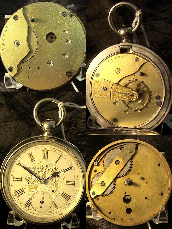

Alex, I post a collage of your watch here, and report;
1. It is a 4 Jewel Swiss copy meant to look like of a (sort of) Waltham model 72-83 KW.
2. It has a nicely hand engraved dial which cleaned up.
3. Looking at the dial plate shows a pair of winding wheels that could be employed with a stem wind or (as in this case) assembled to a square shaft for "Key wind".
4. The mainspring was broken, so I installed a new one and it does not run, a watchmaker could probably get it to run with a day of hard work.
5. The stamped winding shaft cup meant to look like a "key guard ring" disappeared into the ether when I was pulling it off it for inspection. I sincerely regret that I have yet to find it, it must be hiding under a large dust mote.
The watch looks nice, but that is all. I returned it to you today.
