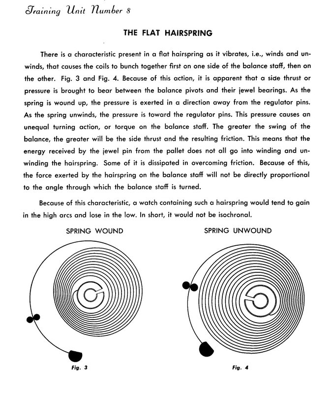

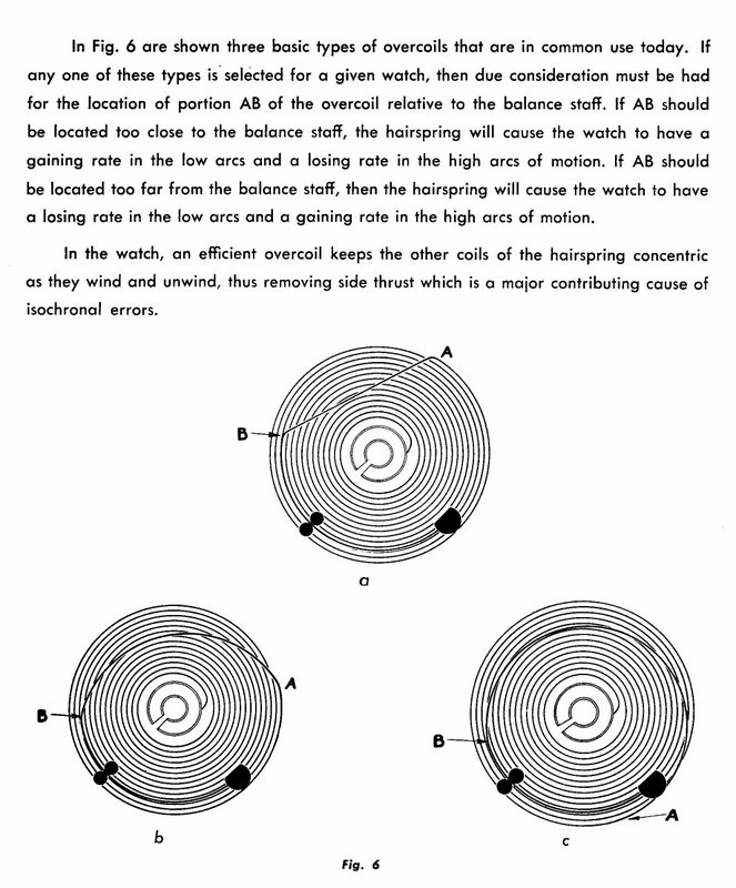

The Lossier Inner terminal argument to open up the first wrap to leave a little more space for the expression of the balance spring around the center arbor was indeed spltting hairs! Waltham's billboarding the Lossier spring on the winding wheels of some of their later model watches was sort of like saying "premuim" for rubber tires. Especially with watches that when you open them up to clean them look like an entrance to a coal mine! However, the same arguments were applied to the Breguet curves (which were much more important to true isochronism and position accuracies), as illustrated by the incredible Joseph Bulova School of Watchmaking Training manual . . .
May 22, 2008, 02:46
Bulova better illustrates the effect of NOT having the Breguet Balance spring as below . . .
