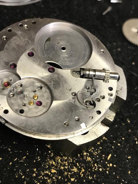

I have a 16s 23 jewel Vanguard Model 1908 model that I just serviced & replaced the broken main spring.
  My problem is I can't figure out how to assemble the shipper spring. I just bought it and assumed it was just a less fancy version of my #1899 Vanguard model.
Can anyone help?

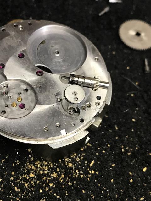

Bila WirriganwaltersHey Tim, whats up with that shipper mate? You should have the setting lever & retaining screw, shipper, shipper spring, shipper cap & it's retaining screw.
Put the lever in place and retain with screw, carefully roll the dial plate over, then fit the shipper on to it's pivot pin that is part of the dial plate with the "C" shape end around/against the lever actuating pin. The round end (hole end) of the shipper spring attaches to the part of the setting lever (actuating pin as well) that protrudes through the dial plate.
The other end of the shipper spring then locks into the small "V" area on the bottom side of the shipper. When locking the spring in to the "V" be careful, as the spring can go flying. After fitting the shipper spring then place the cap over and then fit retainer screw, all done

Bila WirriganwaltersThat is the same Tim, fits as I said in previous post. Do you have the screw to hold the round cap on?

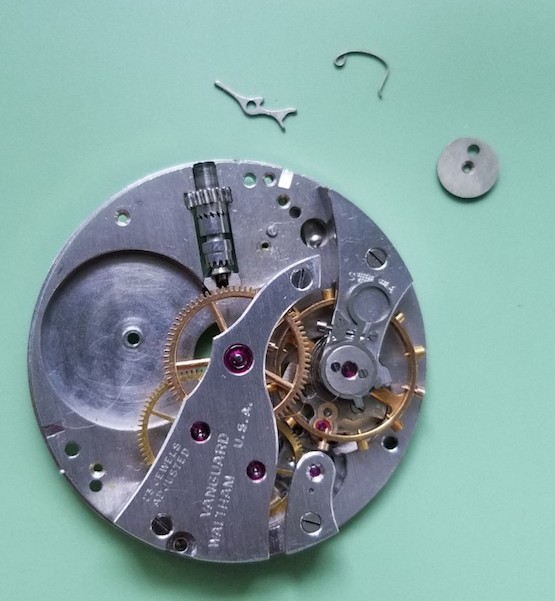

Gary E. CochranTim,
I sent a couple pics to your email address...They should hook you up..Gary
September 16, 2018, 17:54

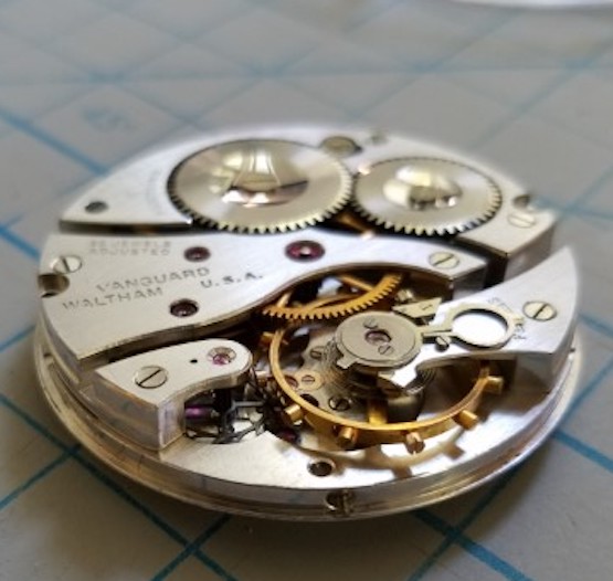

Gary E. CochranI will post them here too..
Gary E. CochranPic 2
September 16, 2018, 18:04
Bila WirriganwaltersThanks Gary, as I described it, the photos should help Tim heaps.

Timothy FitzgeraldThanks everyone for the help. All together & working great.
