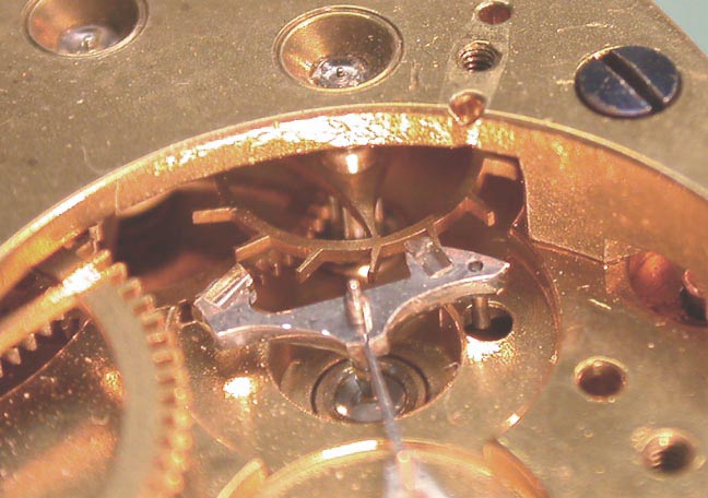

Daniel, here's a shot of an early Howard #3882 with a single banking pin.....

Dr. Clint Geller
I believe Howard took the idea from the Glashutte watchmakers, so it could have been Howard, Assman, or Lange, etc.
