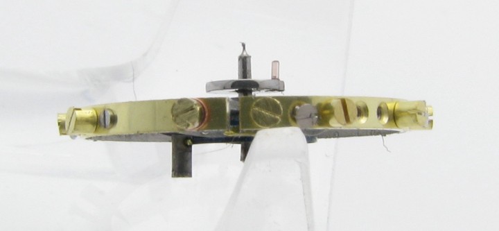

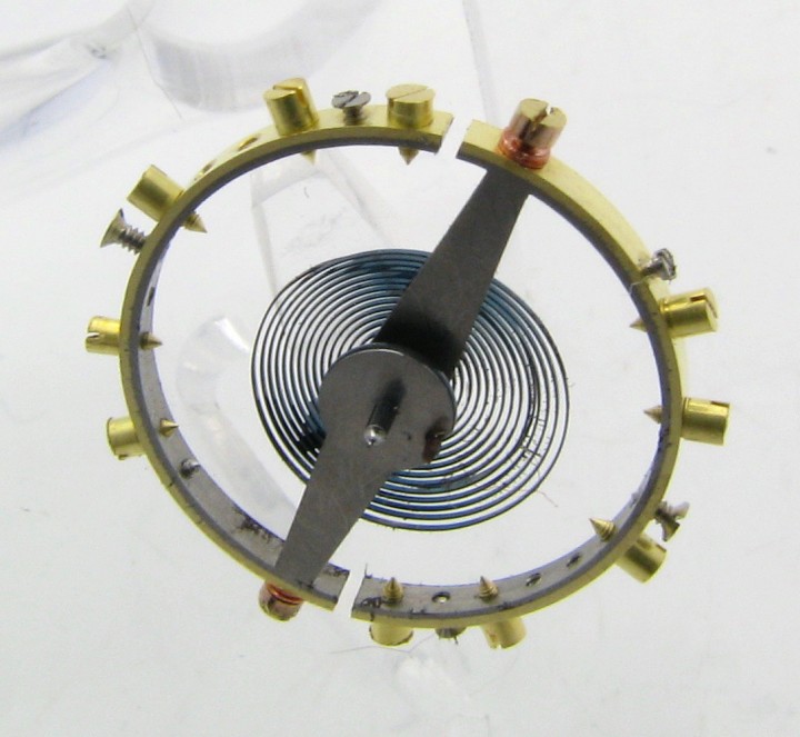

I just had a watch given to me for repair that he had taken it to a “Watchmaker/jeweler/Blacksmith” in his town, he had trouble getting it back from the blacksmith sorry watchmaker, he was told it needed new staff and mainspring COA and he could do it apparently cheap Well he got the watch back months later more knocking than ticking, not wishing to take it back he brought it to me see if I can rescue it.
Well here is the repair attempt, to time it out it first error, he put such a large mainspring in it that its knocking and of course running extremely fast so he started adding small screws destroying the balance arm threads, touch of glue helped and a couple of washer under the mean time screw is a attempt to slow it down, the staff of course is wrong, roller hammered on to approx depth, collect destroyed, the list goes on, case and stem etc are all incorrect so the cost of repair will far exceed any practical attempt to reverse, perhaps the first repair wasn’t so cheap. I get things like this all to often and on occasion some like this that total a good watch.

You get the impression there might be a bit of amateur carpenter in this guy as well Roll Eyes those almost look like wood screws in the balance.
April 09, 2010, 14:05
Edward L. Parsons, Jr.
Apparently so, amateur is the key word here.
The guy responsible for this atrocity is someone I definitely don't want working on my watches! Eek

The wood screws are a nice touch. He must have been out of split shot.

Geez Chris, give the guy a break, at least he knew enough to install the "wood screws" in pairs! Smile

That’s the scary thing how many more is he producing and are out there with quick fixes,
100+ years of loving care and service, destroyed in minutes.

SmilePerhaps if he had cleaned the 'wool' out of the hairspring, it might have run slower,; and not needed so many adjustment screws! OR did he think that you needed some 'hair' in the hairspring!! Cheers from the Aussie... Cool

That image is truely something. A balance or perhaps a wheel off of the Flintstones family hauler.
That image is a keeper Big Grin

Were ther any ball peen hammer marks ?
