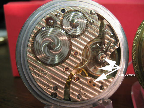

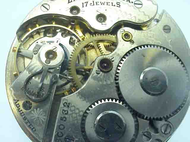

Hi Robert, Correct me if I am wrong, but there is a cap jewels on the balance. I took some pictures from a ebay auction to show. The first picture shows a clear cap jewel, the second is the same movement.
974 Hamilton #1
April 25, 2008, 19:43
Leon Harris
here is the second picture more of the balance.
April 25, 2008, 20:59
The only cap jewels on that nice 974 are on the balance cock, and the later 992 was mainly changed to a "21 Jewel" for the fact that Hamilton added 2 MORE pairs (4 more jewels) of cap jewels. (lower two white arrows)
