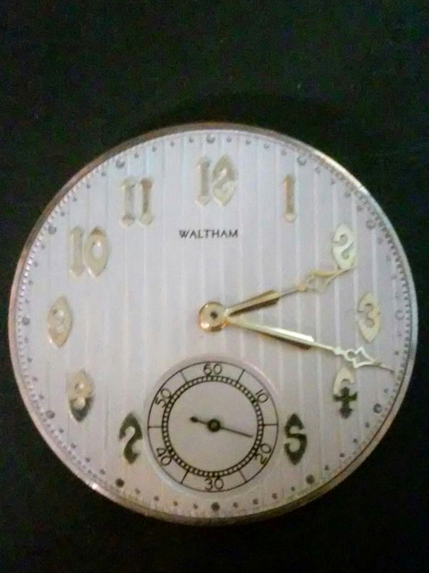

Hello All,
I recently purchase a 21jewels Waltham Riverside A Model Colonial and it did not have a case.  When I lookup Waltham Riverside Colonials online doing research on serial numbers before I make a offer to buy a watch that is not working for the case I see conflicting information in the pocket watch database.  My serial number below shows as a 14s and the chart says it is a 41.49mm and other watches that are in the database say colonial for the size, and there is no actual size in mm given in the database?  Can someone help me in my quest to find a case for my pocket watch movement?
Grade: Riverside A
Mixed Run: 19-Jewel and 21-Jewel Examples Reported
Manufacturer:	Waltham
Manufacturer Location:	Waltham, Massachusetts
Movement Serial Number:	23086471
Grade:	Riverside A
Model:	Colonial
Estimated Production Year:  1919
Run Quantity:  1,000
Total Production  7,300
Movement Configuration:	Openface
Movement Setting:	Pendant
Regulator:	Patent
Hairspring:	Breguet
Adjusted:	Yes
Adjusted to Position:	Yes
Railroad Grade:	No
Data Research:	1954 Waltham "Gray Book" List
Thanks
Robert :-)

Nathan MooreThe Waltham Colonial models were offered only as complete watches, cased at the factory. The designations can be rather confusing since the company produced several movement sizes under the “Colonial” moniker.
12-Size Colonial Series
The first model offered was described as the 12-Size “Colonial Series,” starting at serial 13,589,001. It is based on the 12-Size Model 1894. This is later referred to by the company as the “First Colonial Series.” The pillar plate on these movements is 14-Size.
14-Size “Colonial A”
The next introduction was that of the 14-Size Colonial, also known as the “Colonial A.” According to Waltham material catalogs, this model was offered in Riverside and Maximus grades from serial number 18,039,501 to 24,577,000. The Waltham serial lists are inconsistent on how these runs are recorded, which contributes to further confusion.
Your watch would be classified as a 14-Size Colonial-A movement.
10-Size “Colonial A”
The next model to be introduced was the 10-Size Colonial A, beginning with 22,280,001 movement number.
12-Size “Colonial B”
“The Colonial,” also known as the Colonial B, is a 12-Size, Model 1924 movement, starting with 23,285,001 movement number.
If you are set on finding a proper case, your best bet is to track down another watch classified as having a 14-Size “Colonial A.” movement.

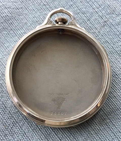

Robert Lewis Van VurenAll,
I paid the piper the $500 for the case I found, and I think it looks great. Let me know what you think?
Next I am going to reach out to William White and have him make me a crystal.

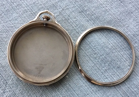

Robert Lewis Van VurenAnother picture of the case

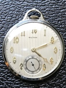

Here is the finished watch.  I have a local friend that owns a watch repair shop and he is a avid collector also.  He had original glass for the case, and I had him finish putting it together for me.
