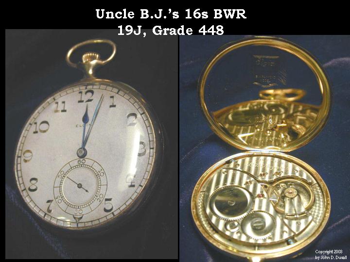

I came across this watch last year on Ebay. It's a BWR, 19J, 5 adjustment 12s spread to 16s watch. Although it wasn't running, I just couldn't pass it up for $48.00. After a good cleaning, it came back to life and is a great runner!
The interesting thing about this watch is its size and thickness. I believe Elgin had already produced a "thin" 12s watch but apparently they thought there was a market for a thin 16s also. Thus, the grade 448 was born. It had the same guts as other 4th model, 12s watches but a larger 16s pillar plate. It came in its own special BWR 16s case. The movement was held in place by a screw and clamp setup. The paper-thin dial is attached by three dial feet and two tiny screws, located at 6 and 12 o'clock. The watch measures only 9mm thick, while a typical 16s is over 13mm.
This watch should be considered a 2 star watch because of its rarity. There were only 1,000 made in 1916. Since this movement cannot be re-cased easily, most of them were probably reduced to parts watches as their cases wore out.

One last thing about this watch; the minute hand. Mr. Daley later told me that Uncle B.J. had a jeweler bend it at the hub. His sight was getting bad and by doing this enabled him to see both the minute and hour hand even when it was 12 o'clock. I tried to leave the minute hand as found but it separated during removal and had to be replaced. Otherwise, the watch is all original.

Regarding your Elgin grade 448 12s spread to 16s: what's the outside diameter of the case?

The watch is 47.15mm in diameter and about 9mm thick.
