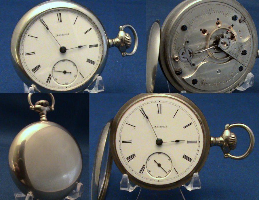

My dad had an old Illinois watch in a box #1180757. It doesn't have a crystal the numbers on the dial are almost gone and the hands are broken off. The movement looks alright but doesn't work. From the serial number it appears to be made around 1893. Is this watch worth repairing and if so what would be a ball park cost?

December 05, 2008, 11:59
You have a very collectible Open Face cased, 18 size 15 Jewel model 2 Chalmers Regulated hunter Movement, Grade 61 made in 1893/4. From your picture, this watch is certainly worth restoration! With that regulator, the movement would probably have been considered "Railroad Grade" at that time. The original dial should have been a double-sunk Glass/Enamel type, but it looks like sometime later in the "life" of the watch someone traded off the case and had the dial replaced for a more "Deco" style "radium type" that has since "faded from view".
To "repair" it is of course possible. You could start with just finding a good dial and use it in the present case until a nice 18s Hunter shows up. It's a great looking movement.
To restore it would require finding an appropriate Hunter Case and a usable dial. I show below a similar movement still in the Hunter case with correct dial that I serviced for my own collection. That is about what yours should look like if you can find a case and dial for the restoration.
