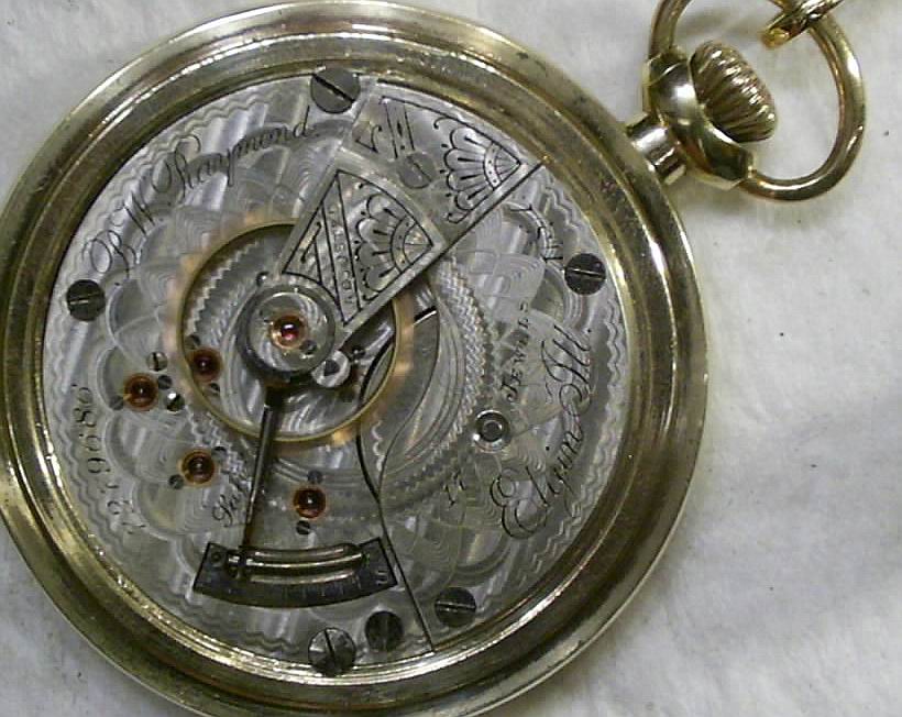

Cecil McGee
The movement

Hey Cecil, plus the fact it is a BW Raymond....
Those old Gr. 184 watches were work horses and very good watches....
Here's mine....notice where the regulator is....
Missing case screw and all....
