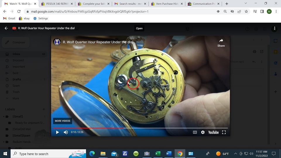

A friend of mine is trying to get an old Girardier repeater back to working.
It is missing the connection between the fusee chain and the strike arm.
I have marked one of a similar watch movements with a circle to indicate where we think he will have to make a link.
But we do not know what the part looks like .
I was hoping someome could take a picture or make a hand sketch to show us the general nature of the linkage.
Thanks in advance for any help.
