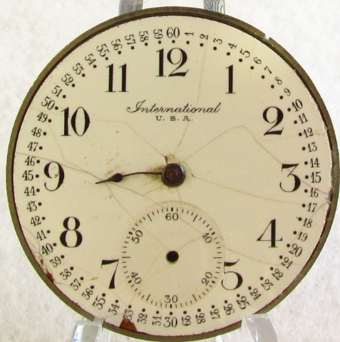

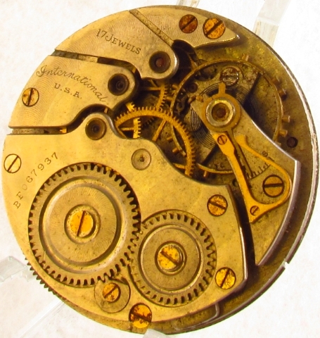

Anyway here are a couple of pictures of what I started with followed by the finished product. I have had this movement sitting in a box for about 5 years or more and I almost sold the case a few months ago because I was never going to collect 12s. Well everything turned out for a reason.
February 07, 2012, 19:37
Harry J. Hyaduck Sr.
Front of movement. This is what I started with.
February 07, 2012, 19:38
Rear of movement. This is what I started with.

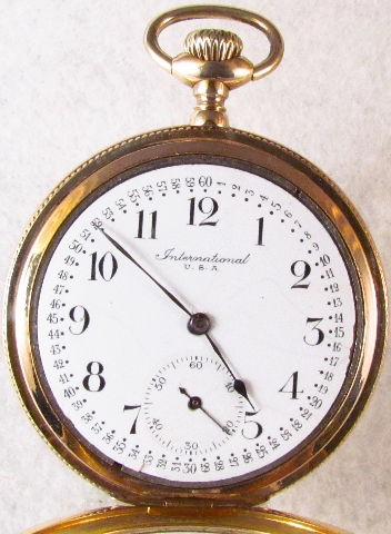

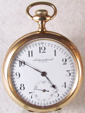

Here is the finished watch.

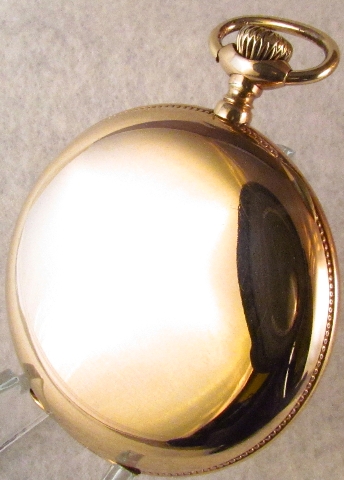

Back

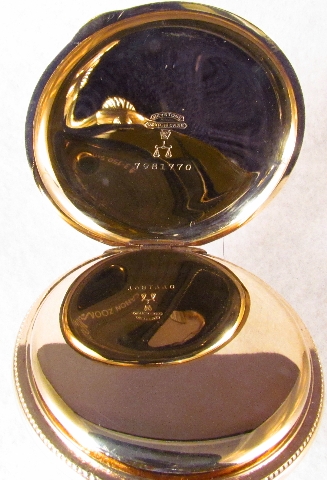

Keystone triple hinged case.

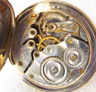

And the last picture is of the movement. But because of the triple hinged case I could not get a real good picture but this is alright I guess.

Wonderful job Harry!
February 07, 2012, 20:06
Jeff R. Moser
Harry hat looks like a NEW watch!! Jeff

How did you get that dial to look so good? It was a disaster before.

Harry, EXCELLENT WORK! Question, which "pairs" of jewels were capped to make it 17J?
I must add that with the cleaned up dial I must change my comparison to an "E.Howard/Keystone-Rockford-Illinois with a bit of South Bend thrown in for "flavor". Those Howard radial numeric minutes look great with those A++ hands!

Looks like it was soaked to remove the hairlines and then had some white enamel that was used to repair it. Harry can you confirm? Very fine restoration by the way.

Jared is right on the mark Brad. Great eye Jared. I soaked it in liquid Comet Bathroom cleaner for about 15 minutes then scrubbed with a cheap artist brush. I then cleaned and scrubbed with a foam hand soap then a last clean and scrub with the Comet (no soak). After it dried I filled the chips with Sheffield Porcelain Touch-up. If I darkened the photo you could see the hairlines a little better. They are difficult to see though through the crystal.
