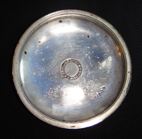

Inside back cover.

The case is in a SB&B [screw back & bezel] case By Fahy's and was their #1 coin silver case, it is desirable today as there weren't as many SB&B coin silver cases made as there were DHB&B [double hinge back & bezel] coin silver cases from that era.
