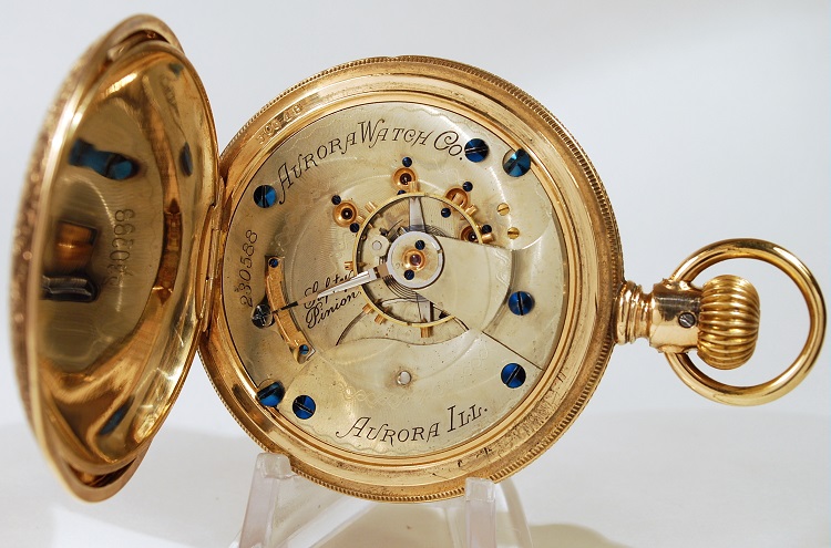

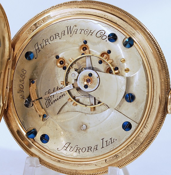

It's an 11-jewel hunter that's keeping Stoner time after a thorough breakdown. I re-inked all the enamel in the engravings, since most of it was missing.
SN 230588, one of the last ones out the door:

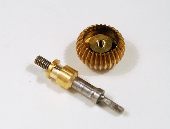

The case had even wear and no damage, and since it looked to be original it was worth saving - but the crown was missing.
The pendant neck had a set-screw, but I didn't have a complete set of crown and stem. I did have a good crown and two separate stems that would work. I cut the stems into their respective halves, and turned the brass slug that would mate with the set-screw in the pendant.

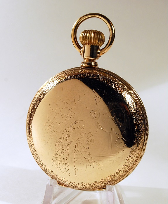

And the original Wadsworth Pilot case, back in action:

John Willis
Nice watch and fine job on the stem and lettering Eric. I am interested in the re-inking of the letters. Could you point me in the right direction to understand how this is done. I have an Aurora # 44102, 15 jwl and nickle plates, with screw down settings. There appears to be no ink in the letters at all. Is this likely or has it all fallen out. My watch is a pendant set. I dont know how rare that is but it seem the ones I see are lever set. I will get it on some day and let you see it.

Using flat black enamel I paint it back in by hand, John. I re-blued the screws, too.

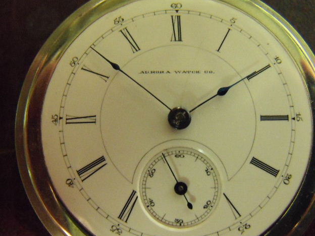

John Willis

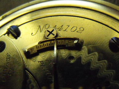

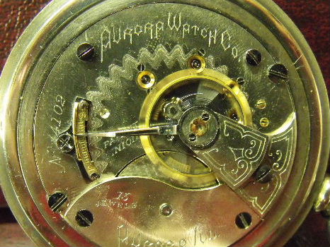

This is a 15 jewel, Pendant set, with serial # 44102. I am curious to know how comman the stem set is. I dont think I have seen reference to another but I am sure I dont have the only one. Anyone have some info I would like to hear.

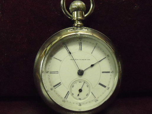

John Willis
This is a 15 jewel, stem set with Hurds regulator that I have had for some time. Ser. # 44120. Anyone know how many stem set Auroras were produced vs lever set.

Tony Dukes
John,
I have written in my notes that there were about 98,000. 18 size movements made by aurora and of that number it has been estimated that there were around 18,500. pendent set aurora movements.

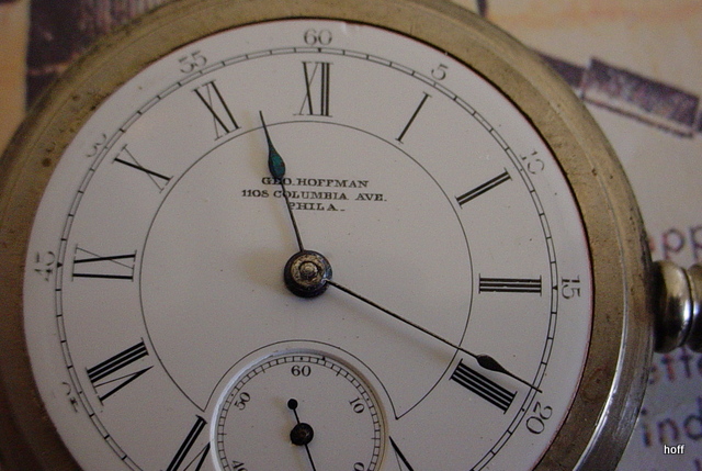

Kevin Hoffman
a private label from a jeweler with the same name as my grandfather [we did have some jewelers}

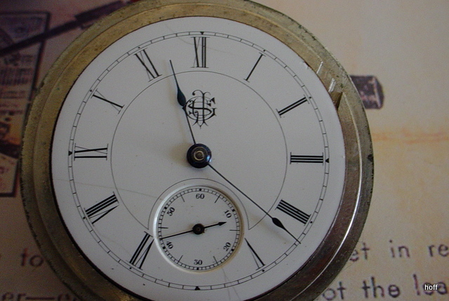

Kevin Hoffman
and another

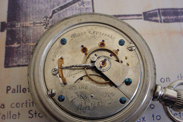

September 07, 2017, 11:55

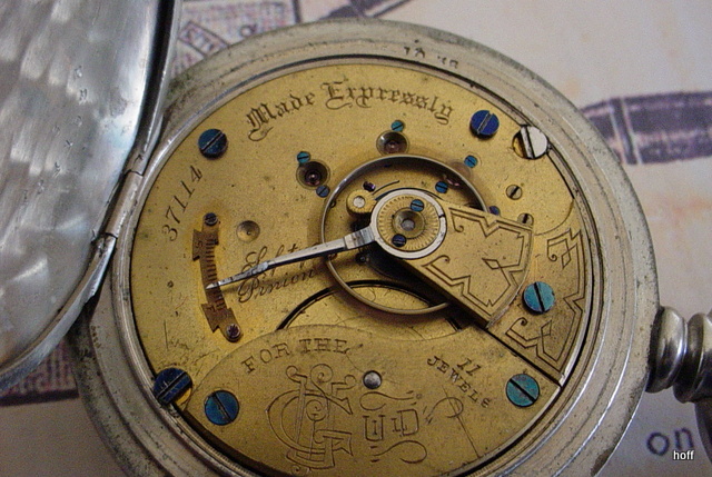

Kevin Hoffman
this is pendant set 11 jewel made for the guild
